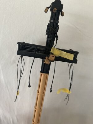

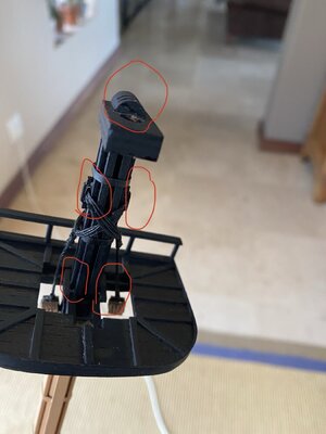

This morning I made More details and started some rigging for my lower mizzen mast. I made these parts not included in kit and rigging plan which are Circled in red.
I have added a bolster with 2 grooves in to my cap. Used a 6mm dowel cut in half and a saw to cut the grooves. The grooves are to support the top blocks and a sling for the stay which will be added later.
I used 2x2 birch and some needle files to make the lashing supports for the main blocks of the yard and 0.5mm thread for the lashing. The lashing line had to be rigged in an up and under pattern through the support.
A 3x1.5mm walnut wood was sanded And shaped for the vertical battens. These prevent the rubbing of the shroud lines against the square part of the mast and cap supports.
I seized the blocks to the lashing with 0.25mm thread.

Good afternoon. I decided not to include sails on my Victory (well kit did not include these so will stick with this) however I will include some of the running rigging for the sails. My standing rigging will be black and running rigging the beige(tan....who knows) color of the kit thread. The kit rigging plans are rather sad and many additional lines and rigging details will be added to get something more authentic.It was Rather enjoyable doing some reading and researching while on holiday.
I’ve never seen those mast details on any other models. Is this something you only find on the Victory?

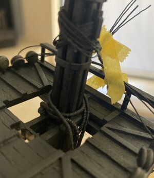

Some more rigging on the lower mizzen mast.

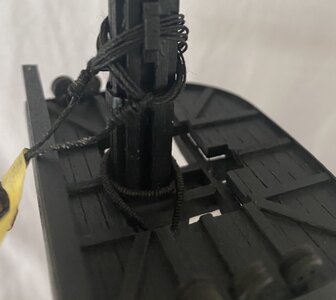

I served the Burton pendants where they fit around the mast. (still have no idea what and why these are there- seem to just hang there but I am researching- if anyone knows please let me know). There are two on the mizzen and four on the other 2 masts).
I did the seizing by hand however I need to make a machine somehow- take so long to do-they don’t look too complicated. To get one here is so expensive and a mission.
I also added the blocks for the running lines to the yard and boom and the dead eyes are fitted using 0.5mm thread. Even after using beeswax mix (still a little showing on the main yard line) the Mantua thread is sad and blocks not too great either. I have decided that I bought this kit and I am going to make the best Mantua (Sergal) Victory I can.
Here you can see the 2 Burton pendants. I used a small black flat bead to simulate the pendants and seized with 0.25mm thread. Used PVA glue to secure just in case.
You've got skills Grant. Nicely done. On my ship the pendants become tackles (used for lifting things). They are the line I just rigged on my build log. I suspect they would serve a similar purpose on your english ship.

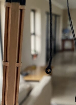

Close up view of the pendant.

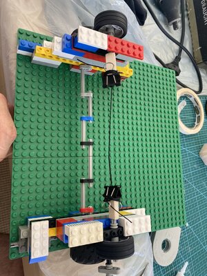

Good morning. I refer @Philski excellent serving machine he made on Marks @Nomad bluenose log. I will attempt to copy this once I have sourced the parts locally here in Capetown.
I’m mean time I made a “jury rigg” or a “Macgygerism” from LEGO I found in cupboard. No laughing guys....ROTF
My first shrouds on the Mizzen mast where served using this incredible machine.;) I used a measurement of 7mm length being the served portion so that it will be served down to the lower end of the Bibb. As each shroud is added this measurement will increase accordingly so all the shroud served sections fall equally at the lower end of the Bibb.
1mm thread was served with 0.25mm. All the tread is stained black with Indian ink. I then run the line through a flame on a candle quickly to try and remove the fuzz. I have not lashed the shroud to the mast yet as I am not sure at which point the lashings are done. The pattern of how the shrouds fit as they are layered on one each other means the placement of the lashing needs to be accurate from the first one. This I will find out.

Oops- 7mm is 7cm. Measurements Eish not my strong point
Man oh man! That is superbly ingenious and the result is spectacular! Very very well done Grant!
