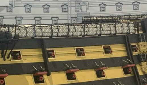

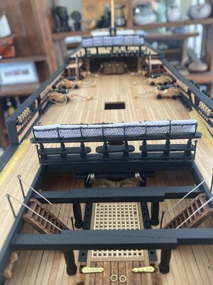

That netting looks SUPERB Grant! Now that very same netting needs to be filled with hammocks ... right?
Goeie More Heinrich. It is my intent to do so however thus far these have failed me.

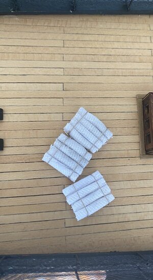

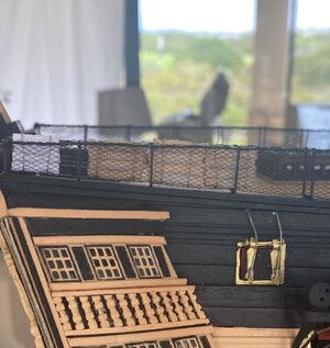

I used some Muslim rolled and painted with PVa and water mix (50/50). My son, in his explicit manner, explained that the Victory looked like it was delivering woman sanitary products. o_O. So I strapped them to make them look a little more like hammocks
Stained in tea for 15min as the white was too stark. I did not like them. Muslim is not the right material - the weave is too large and they don’t finish well.
The other question- some modelers roll them, like I have while other fold them up. The folded ones protrude above the netting’s where the Hammock cranes are smaller. I can’t find any authoritative text on which way these actually go. When I do I will post and continue with these.

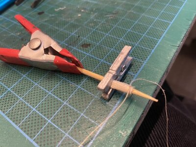

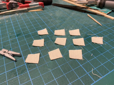

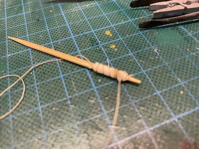

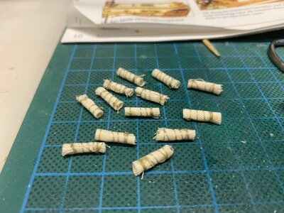

The following comes from Modelbouwforum as executed by Koos in his Victory build. The tip, however, comes from the one and only @pietsan Piet Sanders.

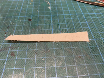

A piece of cloth (I know you are going to ask me what type of cloth - I don't know yet), was first cut to a width of 12mm and then marked 14mm apart.
These are then cut on the markings.

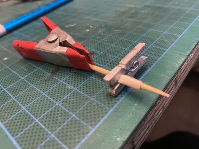

It is then rolled around a toothpick or cocktail stick and clamped into position with a clothes washing clip.
With 0.10mm rope, a knot is made on the one end.
And while holding the rope in one position, the toothpick is rotated so that the rope is wrapped around it as on the picture. Both knots are then secured with a drop of CA glue.
This then results in hammocks of 12mm x 3mm.
And after making approximately 350 of those, you should be good to go!

Thanks Alexander and Thomas. Yep I thought this may be the historical way of lining the hammocks in. As I mentioned these do not look so good in the small cranes. Heinrich (some guys gonna beat me for this;)) I may still be using your method. It just looks better. On those models where hammocks are in- most don’t. Thanks all.
In the daytime, the hammocks were carefully rolled up, with the bedding and perhaps some spare clothes inside them. The boatswain is to pay particular attention that when the hammocks are piped up, they are taut and nearly lashed so that no bedding appears. No clothes are to be shown in them.
The hammocks were placed in netting arranged along the sides of the ship, for it was believed that they have some value in stopping the enemy fire. In bad weather, the hammocks were lashed uptight and kept below decks.

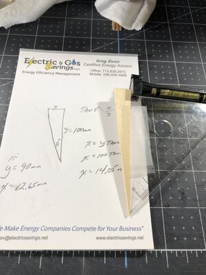

My plea for help- maybe @Alexander74 or @Thomas Marocke or @Jimsky or @Heinrich (sorry British ships againROTF) or @anyoneelse will be able to assist me here.The rake according to my plan sheets are (degrees from vertical) :foremast 0, Main mast 2, and Mizzen 4.
My research has come up with foremast vertical Main mast 1.5 and Mizzen 3.5.
Would the 0.5 difference matter , is this calculated from the deck line (it is not horizontal on the Victory) or from a horizontal center line and lastly are these figures correct.

Jim thank you - much appreciated
Hi Grant, in determining the rake or inclination of the mast on the Vasa I drew a center line on the mast (directly on the plans) then drew a vertical line that met the center line at the railing (it does not matter where the vertical intersects the mast centerline) the angle remains the same. Then I measured the angle with a protractor to the nearest full degree.
You were wondering if 1/2 of a degree makes a difference. Let's see, if y=100mm and the angle is 0.50 deg. x=0.87mm. So, if you had a total mast height of 1 meter, distance x=8.7mm. To me, I would have a very difficult time trying to achieve 0deg 30min accuracy with just a protractor. Therefore, I would just measure to the nearest full degree and not worry about it.
Hope this helps.
Hope this helps.
It does Daniel- a lot. X and y’s where a long time ago especially when a tan is thrown in;). The full degree measurement works for me. Thank youThumbsup. I have some adjustment to do (small amounts thankfully) so I should manage this ok. “Touch wood” Cheers.
