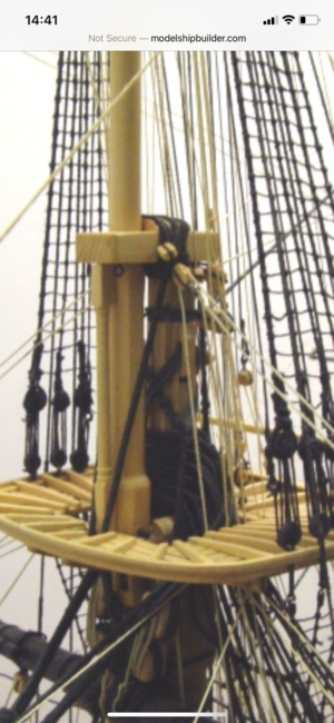

At time I have used a scratch build Victory by EdT as a reference and this is what it should be closer to.

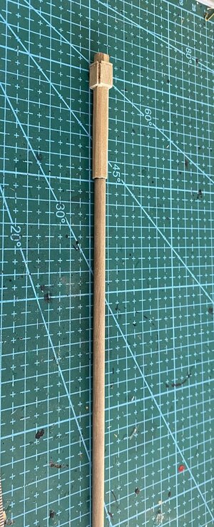

I took some left over wood strips glued them together to make a square, planked with left over 6mm planks and then using an exacto blade and carved a sort of, close to, irregular octogonROTF. I cut the dowel shorter so the mast will be in two pieces. Drilled a center hole in the dowel And the octogon inserted a wooden support column for strength. Made the square block at base- made this too short and had to add some small adjustments. Can be seen in below photo.
Will need to to more shaping, clean up, and some wood filler will be needed on block at base. Sand. I think this will look better :D

View attachment 290713View attachment 290712

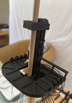

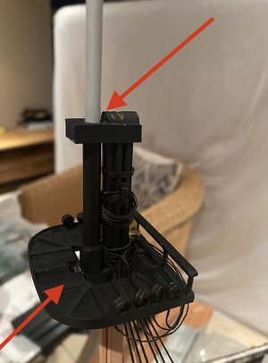

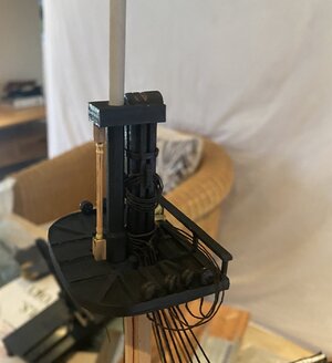

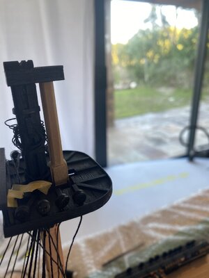

Good morning- mizzen mast continued: When making changes to kit design, everything has a consequential knock on. Lack of experience wake up call for sure. I had to move the hole for the mast in the cap forwards (Upper mast would lean too far stern not 3.5•)and adjust the crosstrees “bracket” for the fitment of the forward column. I used needle files to do this. Making a mess of my paint work etc Cautious. Will be sorted hopefully. I am also making the the notches for the stay sling bigger.
Experimenting with the support pillar in picture 2. Using tamiya masking tape cut to .25mm to see if I can make the decorations (will help if I put them on straightROTF). I have also adjusted the scale- kit was too big again. I previously made this and as you can see have broken it down some. I feel like when my son says “Dad just hit it you can do it” when trying those technical downhill sectionsSickROTF.
All dry fitted.
Admiral thinks I’m crazy- “no one will even know the difference “ ......hmmm she may have a point. Have an awesome day guys. Cheers.
