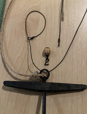

block tied to the ring
Agree with Alexander. It's a bit strange. There must be a hook.
Grant, buddy, hi. Where did you see this method of attaching the anchor. I'm talking about a block tied to the ring and a rope? I see this for the first time.

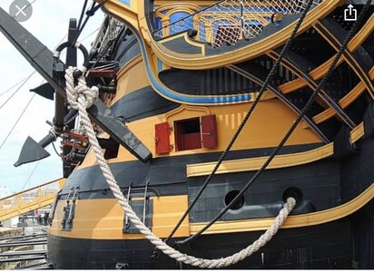

Good morning Sasha. With my limited knowledge of ship building, I saw this on Gil Middleton’s build. Here is the Portsmouth Victory:
In Gils build he refers to David Steels reference on the site Historic Naval Association (The Elements and practice of rigging and Seamanship). I started going through this however it is a lengthy document so jumped to the Anchors.
I would have thought a simple bowline knot would work;)
Cheers Grant
I don't think you want to tie the block any time when you raise up the anchor, or to throw it into the sea with it :)
Thanks Walter- yes that makes complete sense - not going to put the block in the sea. I will have to make a hook around the block and attach the messenger line to the Anchor ring. This picture is a great reference. Cheers Grant. PS this is why make one first and let SOS crit it for you. Thumbsup Cheers Grant

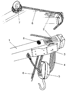

Hi Grant!
Another picture for understanding. The pulley with ring lifts the anchor out of the water. The other rope (rigging line) secures the anchor to the ship.
Best regards
Thomas
Thanks Thomas- Yes, this confirms @Walterone and @Alexander74 advice and questions. Makes it clear. Funny that now I see it it is obvious. Much appreciated. Cheers Grant

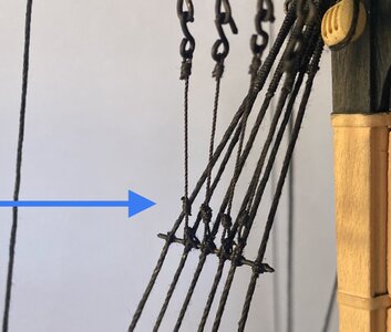

Hello Paul. I downloaded them. Certainly will assist me. Re the Futtock shrouds I was super lucky as my guess work Re thread size matches these plans exactly. Re the tying off of the Futtock shrouds to the staves Caldercraft is not Historically accurate, however I am going to do redo mine their way. I don’t like the whipping on my first attempt (blue arrow). Whilst this enable me to lash them to the staves correctly the Futtocks don’t have whipping on them and they going to get in the way of the Ratlines. Cheers Grant

Good morning. I redid the anchor tackle. Made a hook. I used @Thomas Marocke diagram as I could not get the hook looking good around the block as shown by @Walterone. My “metal work” needs loads of work and some tools to assist. :rolleyes:. The sling and messenger lines will be connected when I fit the anchors later. Cheers Grant.
Lookin’ good, amigo!
