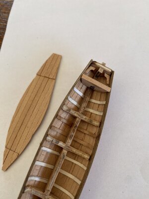

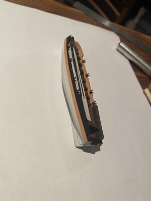

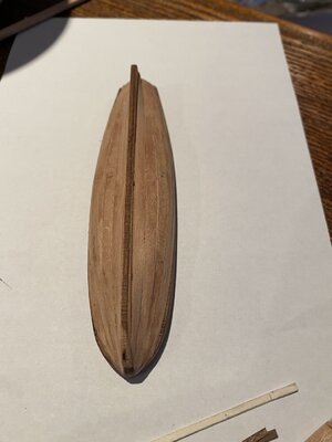

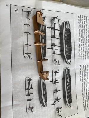

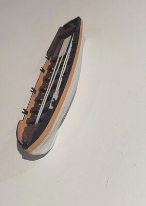

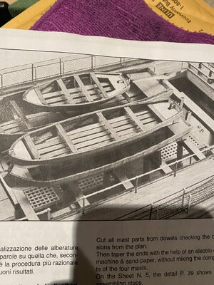

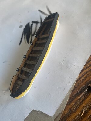

Good morning. A while back I decided to start making the Pinnace, the 2nd smallest of the 4 lifeboats. I started making the Frames according to the instructions and gave up as these are not even resembling what the life boat look like. Had no idea how to continue as don’t have the skills to make a scratch POF at this scale nor do I have enough wood.

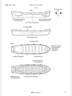

Jokita (Caldercraft) instructions, thanks to @paulv1958 advice has cool instructions so I modified my frames and gave it a go. Here are the diagrams I downloaded.
As you see the kit is so way out ......RedfaceRedface:eek:
Here is the mess as I went along - trial and error was the name of the game- outcome based vision kept me going...like so many aspects of life. Took many hours to make this little Pinnace. Been on it for some months off and on when rigging made me o_O
I planked the Mantua frames with 0.5mm x3mm walnut. I wanted a wood planked look so polyfiller and smooth filling was avoided. The Pinnace will be painted so I used CA glue mostly.
I took my Dremmel in @Vfordyce style ;) and cut away the bulkheads and sanded down best as possible.Could not achieve the desired effect as the Pinnace is small and sanding and tools don’t get in.
Started ribbing with 0.5mm walnut cut to 1.5mm however these kept breaking so simulated the ribs with cardboard. Used one of the Mantua frames for stern bulkhead (planked the top as the plywood looked horrid). Made the transom knees.
Planked the decking onto paper which I cut to shape and double planked the stern and bow part.
The Mantua boat only had 5 thwarts (should be 8) , no sternsheets, washstrakes, crutches, oars, helmsman area and transom knees. The bulkheads are not in correct place so my ribbing and position of the thwarts will be a little out. Kept going.....
Added the foreword and stern wash strakes using 1x4mm and bent and sanded to size.
The Pinnace has 8 crutches and 4 oars. For the crutches I raided my daughter beading box (Ashtyn is in France so she won’t miss them:rolleyes:) and found Copper hoops which I cut in half and glued. Painted black. Stained the deck, thwarts, sternsheets and helmsman area at stern. Painting: way more difficult than I thought.
Made some oars (still WIP). Still need to add some decorations (gold)
My WIP Pinnace so far: I know what to do for the remaining life boats and I will be able to get these neater for sure:
I am encouraged with the outcome so far and besides the dremmel slip on forward gunwale below the washstrake it is getting there.
Cheers Grant
Well, I'm impressed for sure. Great work ethic there, Grant, with a good few doses of innovation to get you over the line. Your pinnace looks great and the colour scheme has turned it into a small work of art, visually engaging, and one of those items that will no doubt draw the viewer closer to your completed model. Second smallest ... so there's one even smaller than that? Great piece of work indeed, a project all of its own, well done Thumbsup
Grant your lifeboat looks wonderful. I don't think you have anything to be worried out. Right now you are focusing on what you could have done better, but once it is integrated it will look like it belongs there from the word go. So, no worries - you did a fine job!
