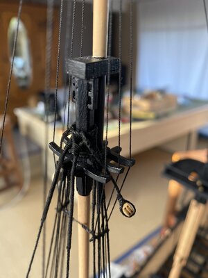

Mizzen stays :

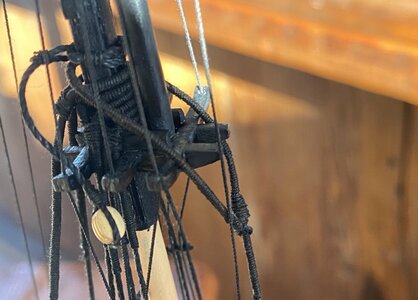

Seized and made a rat ( Grants Just don’t come out tidy- at least will be consistent through the ship;)) tried two different techniques-1: used small dowel, drilled center hole and fitted onto stay, shaped and then seized, 2: seized line wound back and forth to create mouse. Both similar outcome. Won’t give up on these tho).
The stays will be place over the seized shrouds - apologies the photo above shows them above the shrouds.

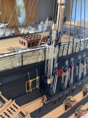

The Mizzen sliding back stays and back stays:

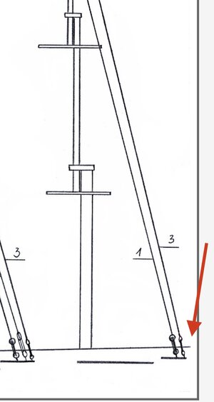

The sliding back stays : a hook was made to fit to the channel and threaded through 2 5mm double sheave blocks. There are 2 back stays and these are fitted through the 3mm dead eyes onto the smaller channel. The stern most back stay is not supposed to go through a dead eye but rather through a fixed eye and lashing. As shown by red arrow in picture below. Sadly, as with many aspect of my build, I progressed too far with the Mantua instructions and I will not be changing this.

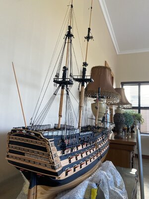

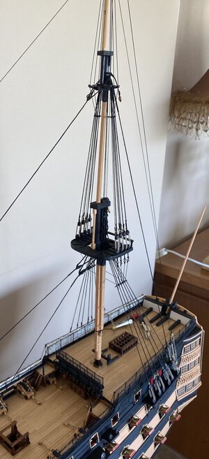

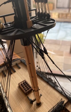

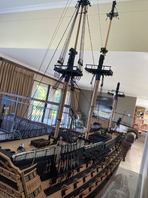

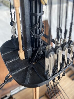

Good afternoon.
My Mizzen standing rigging progress on “Grants Victory” - it’s not a Mantua anymore way too many changes and additions and is nothing close to the historic authenticity of this majestic vessel. So we will call it Grants Victory :D:D.
Much trial and error in learning how to rig and learning about the principles of how these ships were actually rigged and what goes where. Hopefully the Main and foremast will be greatly improved.
I would like to thank all of you for your encouragement, likes and especially those wise words of advice and help. Massively appreciated.
Some pictures which are not close ups. Lots of WIP so loose ends, ropes not tied off, Main mast and Foremast not seated, stays and back stays not tensioned etc etc. Just for you guys to see “Grants Victory “ Those futtock staves and mouse’s.....EishCautious

Good afternoon.

Good afternoon.

Wow "Grants Victory" is a fantastic looking ship, if I built that I would be very proud so great job.
