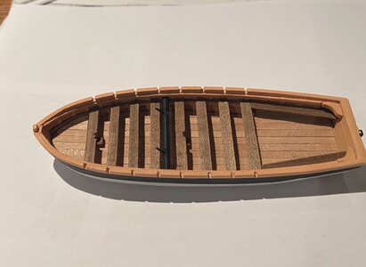

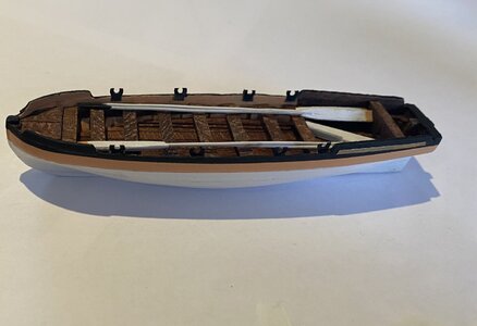

Good morning. I have been working on the Victory boats. For the Pinnace I started the gold strips on the water wash. Used masking tape cut to size and painted gold. Also started the paint details to the oars and cut a rudder (smaller than kit was too big).WIP.

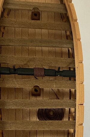

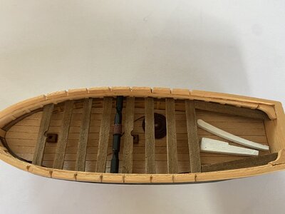

The Launch has been built over the past weeks, bashing the kit in a similar manner to the Pinnace. I have used the Caldercraft drawings and other builds to try and find something a little more resembling the launch than the kit. I decided not to stain the Launch And Barge as these will be on the deck of the Victory, while the Pinnace and the cutter (also dark stain) will be hung from the quarter Davits. Simply put- I don’t like the dark stain when on the deck.
Launch to date:
991ABD2B-C50F-4F18-A198-464692EE36D9.jpegB0580E19-04FD-4A95-AA7D-828344A248BA.jpeg56C62833-4113-49D6-B5E0-181E055F23FD.jpeg
Basically scratch built. The windlass I made a octagon from a 3mm dowel (well sort of an octagon ;) ) and the mast fittings from 2x2 birch stained. The ribs and seat fitting strakes are cardboard. TIP: (don’t dye your hair greenROTF)- seriously think ahead- I fitted the windlass and then attempted to add the rope and coil. Would have been easier if I did this prior to fitting the windlass. The sailor who did that coil is not having rum for a while for sureROTF.
Now for details on both and loads of paintwork and light poly- From my disappointment of the kit boats to now I am happy and holding thumbs they will look good enough for Grants Victory ;).

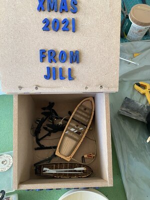

Good afternoon. I have packed my boats into my WIP box, along with my Anchors, quarter Davits and lanterns. (A gift from one of the HR managers - “Grants Doos” - literal translation is Grants box, however in SA slang I cannot translate on this forum)...... It is time to get back to some rigging. Cheers GrantB6BBD6E1-CCD2-4AF4-A957-38D93975596C.jpegB3253137-0929-4D9F-B70B-8B033FCD1836.jpeg
