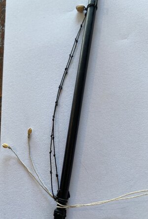

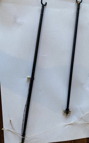

Good morning. As I said back to rigging...well more blocks.
The driver boom and gaff.

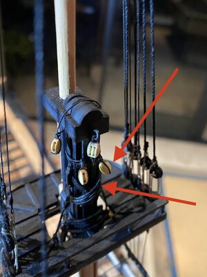

Firstly had to add the lift blocks to the Mizzen mast :

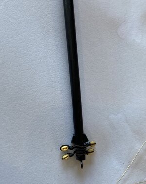

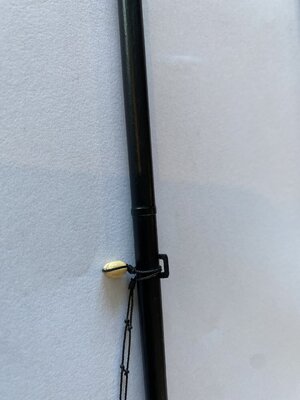

The Driver boom: 2 rope walks(Horse) where made using 0.5mm rope with a “granny “ knot added every 1cm and whipped to the boom. A 5mm double sheave block was used for the sheet tackle. I made the little “u block” which holds these. Kept breaking as the walnut is very brittle. Probably just very old.
The lift ropes, vangs and horse attached at end of boom.

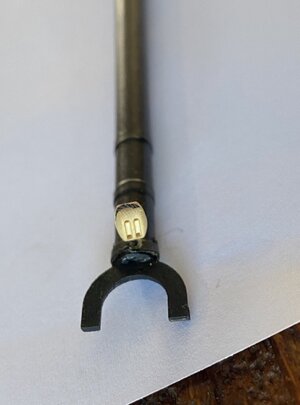

The gaff : 3mm single sheave blocks for the topgallant and topmast yard braces together with a5mm double sheave for forward lift are added.
I used the kit jaws and I am not sure I’m going to stick with these. I need to add parral and these look too thin. Will see.
Cheers Grant
