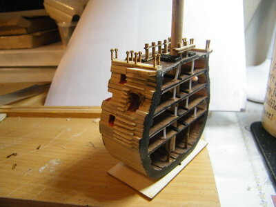

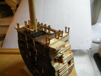

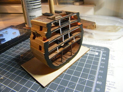

My new build still using to improve my skills

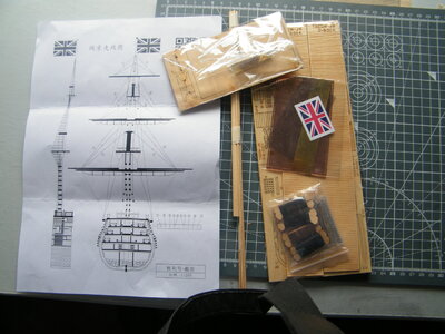

So chose another cheap Chinese kit as always you get what you pay for.
Selection of photos as it starts.

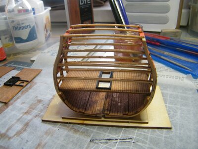

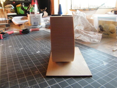

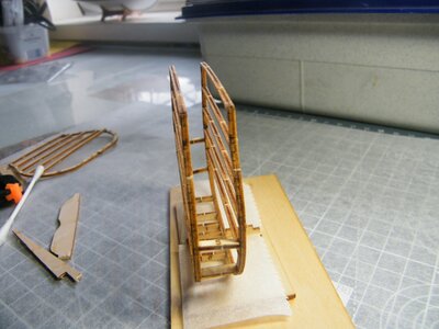

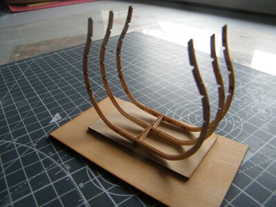

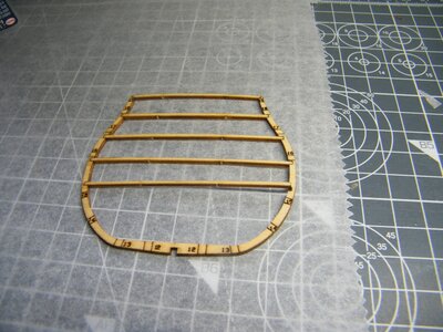

The material is very flimsy i tried the way the suggested and fitted the ribs to the keel but when trying to fit the deck supports it was prone to being damaged.

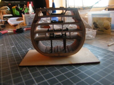

Next tried fitting the ribs with the deck supports before assemblyDSCF8818.JPGbatch_DSCF8819.JPGbatch_DSCF8820.JPGbatch_DSCF8821.JPGbatch_DSCF8822.JPGbatch_DSCF8835.JPG which was much better.

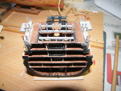

As the lower deck and the internal planking was added it increased stability and improved my confidence of handling it without the feeling that it was going to break every time I touched it.

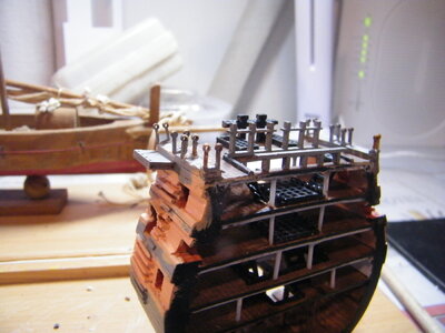

Ok so been a while since my last update I have been doing little bits just never seemed to get around to posting so here are the latest pics.

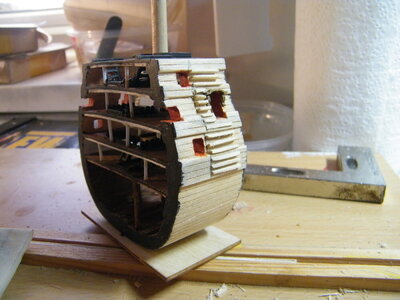

frames and decks installed with internal planking.

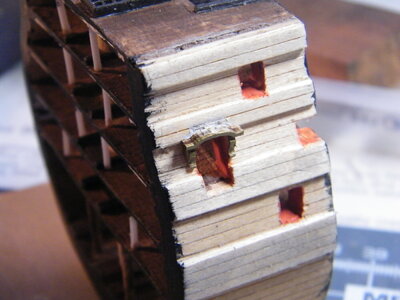

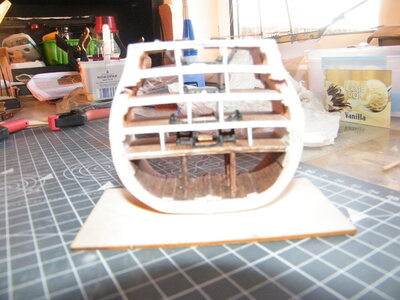

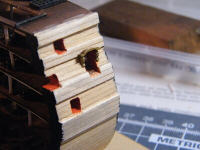

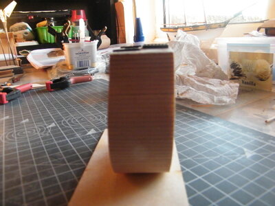

have fitted the outside planking but need to cut out the gun ports.
Think next time would prefer to try a bigger scale
