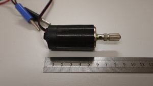

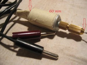

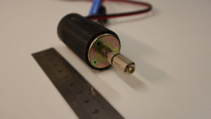

Some days ago we discussed the possibilities of short and small electric drills.
Especially making treenails inside the hull, often you have not so much space for a dremel or Proxxon,
Until now I used here fore a handhold drill, but after some dozens or maybe hundred holes......

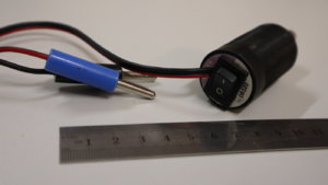

So I thought it is time for a short electric drill - so here you can see my new selfmade drill.
With switch on / off and fits into the plugs of my Proxxon MICROMOT mains adapter NG 5/E
Only 9 cm long...... I am not completely happy with the motor - axis - so I have to still improve it ....... but ......
