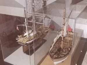

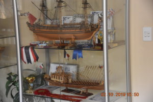

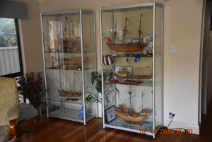

In my opinion a showcase is an obrigation for a model like our ships. This one i made for my first project, the Gjoa. It´s glass.
The problem is, that the details now are far away. You cant get close enough with the eyes to explore the model. My next case i will plan different. When i have visit or interested persons i can remove the case to show the model from near. The problem of glass is the weight. I will switch to high quality acryl.

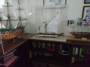

@janos I like the idea of the glass cabinets. Very nice collection of build models, and BTW nice collection of trophies!! What competitions have you participated? Do you participate, still?
Hi Jim,
These glass cabinets are used by jewellers and in stores selling small items. Very handy, glass all the way around and they come with their own lighting too.
I usually participate in the annual exhibitions of the Sydney and Canberra ship model builders, sometimes on the Port Macquarie one, and once only on the Sydney Easter Show. Hence the trophies (not all are shown only, they would cover the models and carvings themselves :p)

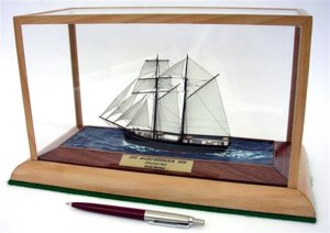

I also use perspex/acrylic - cut to size simply by the supplier who scores it then "breaks it over an edge rather like a tile - but with more expertise than I can. I "stick " the edges with chloroform applied as a liquid with a paint brush. I use a wooden or mdf base. Sizes from small to 1300x90 without problem.

for ease and reduced cost (perspex is expensive here) no wooden frame, and just simple floor- even an old kitchen cabinet door cut to size. I kid myself that the masterful wooden cabinets or fancy bases detract from the ship itself.

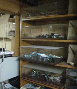

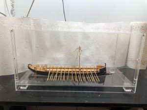

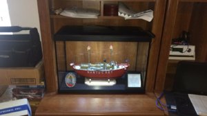

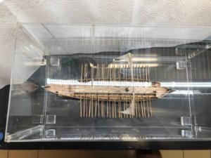

I tried an "improvement" to my basic acrylic cases. I find the very thin acrylic cement difficult to control even in a hypodermic syringe and a spot on the sheet mars it . I tried using 0.25 inch square acrylic rods at the corners and assembled the case with small brass plated screws. A little longer to make but a bit more control. The rods are about $3 for three feet. This case is 18 ins x 9 ins x 9 ins and cost about $50,

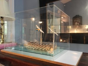

For the Oliver Cromwell I just finished an acrylic case has been bought. (City West Plastics, Ryde). Huuuuuge! Hardly fit into my 6. But very good quality, it will stand time!
