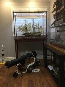

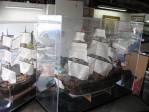

For the Oliver Cromwell I just finished an acrylic case has been bought. (City West Plastics, Ryde). Huuuuuge! Hardly fit into my 6. But very good quality, it will stand time!
Janos
Hope to see once a photo with the model inside.....

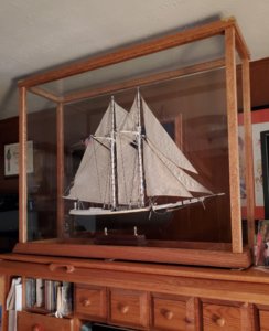

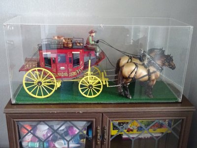

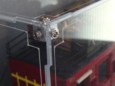

I tried an "improvement" to my basic acrylic cases. I find the very thin acrylic cement difficult to control even in a hypodermic syringe and a spot on the sheet mars it . I tried using 0.25 inch square acrylic rods at the corners and assembled the case with small brass plated screws. A little longer to make but a bit more control. The rods are about $3 for three feet. This case is 18 ins x 9 ins x 9 ins and cost about $50,
I'll try the wood corners tooView attachment 132890View attachment 132891
Good idea/ is the base free-standing?
Yes, the base is free sranding. I wanted to give the para some support so used a sheet of acrylic with a basic cut out to hold the hull at the approximate waterline. It's mounted on four one inch acrylic cubes and it slips nicely into the case. TAP Plastics cut the sheets accurately so it all assembled nicely.
