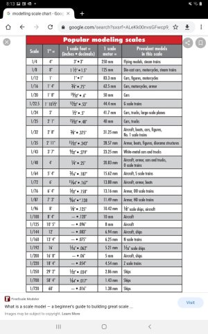

My viewpoint is that of a scratch model making all parts myself except cordage and chain. In some cases, I include one or more figures on the nameplate and I buy metal kits for these to be assembled and painted. My projects typically require several years to complete and before beginning one, I consider a number of factors:
Overall artistic objective; model type-exposed framing, fully rigged, etc, Finish-usually painted, Display- plinth finish, supports, etc. It is important that these things complement one another.
Research; Can I find reliable information to build an historically correct model? I do not like or use “model makers” plans as I have no way of
judging their accuracy.
Personal: Does the subject interest me enough to allow me to complete the model? Artistic vs Engineering- I have no artistic ability but am able to “engineer” the models by making jigs, fixtures etc. Finances- usually not a factor for scratch building.
Workshop- I am blessed with a spacious, well equipped shop so not a factor.
Scale- I choose the largest scale that will allow the model to be displayed in my home or in the case of my present project in a known public space. This size must include a glass display case. I also avoid projects where the scale would be too small to allow me to achieve my artistic objectives.
So. Scale is only one of many factors to be considered and there is no single best scale. It depends on the project.
Roger
Roger
