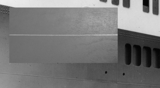

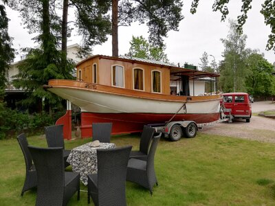

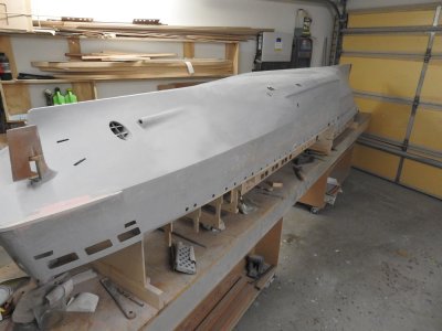

I am building a model of an open steam launch. The original hull has been made of steel by welding, leaving the seams of steel plates visible. I wonder how can I simulate these horizontal welds at my hull like in attached photo?View attachment 220957

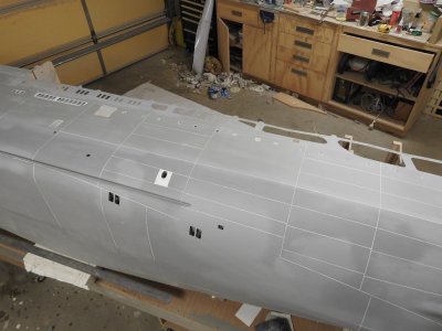

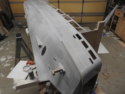

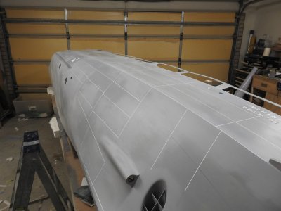

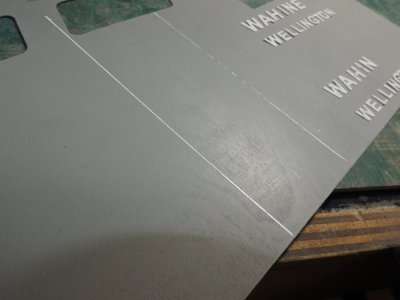

The way I do it at 1/35 is as follows.
Prep the hull with primer to 400 grit, this is Tamiya fine surface primer, a lot of it!.
You want the final pre paint surface
Mark out the hull with a soft tip pen according to your shell expansion.
Start masking these lines about .5mm wide (carefully), this equates to 18mm or 3/4 inch wide beads which is about right on ships.
With a brush build up the area with high build primer, something hard like Mr Surfacer its actually pretty resilient and you have the added fact that if you stuff up and are not happy with it you can sand it off! and do it again., I prefer to use white for the beads on Grey, as a guide stop when you can no longer see the paint sag down into the groove between the tape.
I had tried Epoxy putty or even using Cyano or epoxy for these but the downside is IF you have to redo one, sanding it off is that much harder and you will sand through all the primer around the area as well and in most cases the bead will pull away taking all the primer with it leaving a long indentation/tear in the surface which now needs repairing.
Then give it a very light scuff with 400 to knock off the corners and then it's done.
I start with transverse seals then do longitudinal.
Note the bead at the back, this was with tape too close together, You must work in 200mm long section and remove the tape straight away or it will pull off the bead, once its dry its very strong.

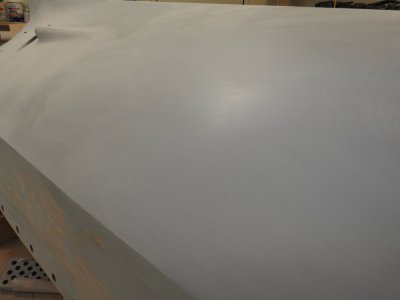

The result compared to a photo on same ship. Please ignore wood grain, this was a test piece and not grain filled.
Notice the very fine undulations in the edge and very slight width variation exactly like the real one, this is a free thing you get using masking tape, not pinstripe tape but masking tape.
