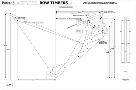

After 11 months of effort, I am at a point where I can start to publish my drawings for those interested. The reason I did not post them before, was because I am currently working on the entire design as we speak. The ship depicted in the movie is a pirate ship, based on a Revell model, I think. I am not quite sure, but I spent endless hours reverse engineering pictures into a solid plan and elevation view of the ship. Over a period of three weeks after that, I began developing working drawings of the keel, bow, and stern. The stern was extremely complicated. This set of plans is a full scale set of plans to build a pirate ship. All the dimension are given in inches with two decimal points. ex.(12.00)

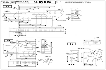

In about three weeks I will be able to publish all the drawings for the keel, keelson, and bow components. You can scale all the dimensions down to whatever scale you want and exclude all the fasteners as a model ship builder, just saying. Here is an example:
