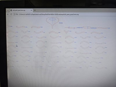

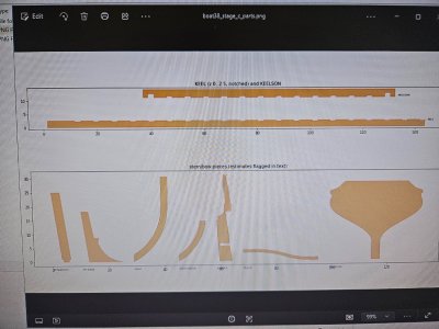

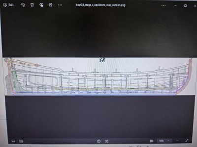

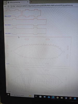

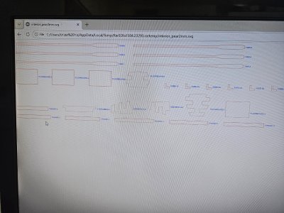

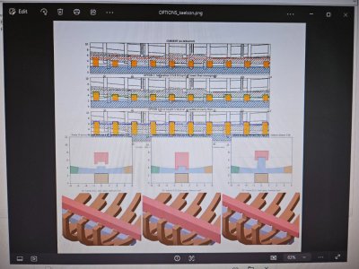

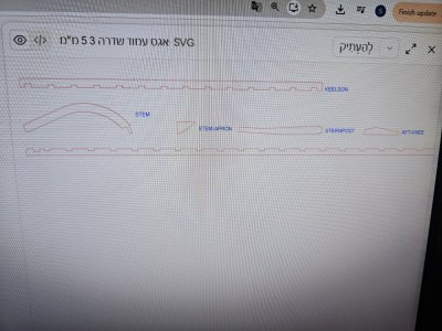

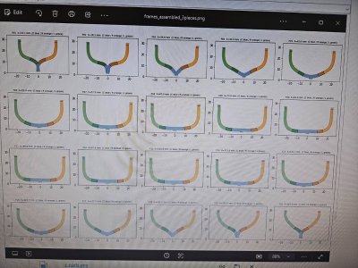

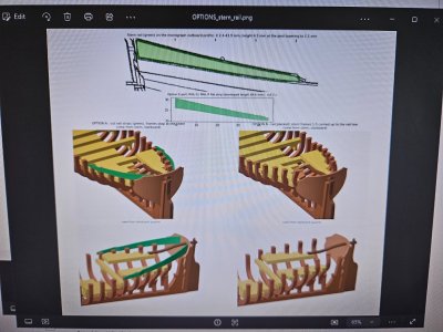

In the last two weeks, I have worked and experimented with two artificial intelligence models: ChatGPT and Claude.
I will share with you my conclusions,
ChatGPT - is not suitable and is not able to cope with the task at the required level
Claude - is suitable and is able to cope with the task at the required level for me.
The work process was scanning and feeding the model the monograph drawings, feeding the model with pictures of a charter boat built by a friend as well as examples of boats sold on various sites.
In the next stage, I scraped a task divided into stages.
In the third stage, which required several corrections of errors and inaccuracies.
The results I received: drawings of the ribs, parts of the keel, drawings of most parts of the boat, a 3D simulation of all parts connected and a jig into which the various parts will be inserted and connected.
I am attaching pictures of some of the products. In the next step, I will begin experiments with creating the parts and connecting them together.
