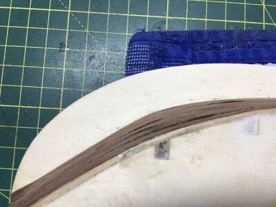

I was wrong again! Thin second planking harder than first...

I’m finding that too. The first layer was a challenge - but I got there in the end. However, the second layer of planks (0.6 mm sapele) have a habit of twisting out/lifting up at the bottom edges when curved around the hull - they won’t lie flat against it. What am I doing wrong? Too little glue (insufficient coverage?), the wrong type of glue (I’ve used PVA, but should I have used contact/cobblers?) or was the faring of the frames not right?
I would have bet the farm that a .5mm thick plank would bend / lay easier than 1mm plank.
good thing I'm not a gambler...
I made the decision to do the second planking with 1mm black walnut rather than the .5 strips on my Le Soleil Royal and I am glad I did!! For me it was easier controlling the bend, beveling the planks at the hull contours just easier to handle!! and had more thickness to the plank for finish sanding when the planking was complete.
I have found that veneers are far less forgiving and after my first ship I will no longer use them preferring to take care with the first layer of planks. Colour (if required) can always be added later with a stain.
The thing I like about double plank ships is the first planking is your Preparation layer the layer where you learn how to plank your hull on your ship the second layer is just a repeat of the first with some adjustments in areas where you had issues with the first layer it also gives you a smooth surface and contour to apply your second planking.
