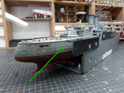

And now we come to my current status with my Mikasa model.
Construction has stalled slightly as I need to consider my next steps.
I don't want to continue working on the bow section at the moment. I plan to attach the chains and davit later, and the lifeboats at the stern won't be installed. So I think it's time to focus on the torpedo net supports and the casemate hatches.

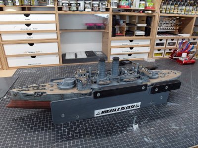

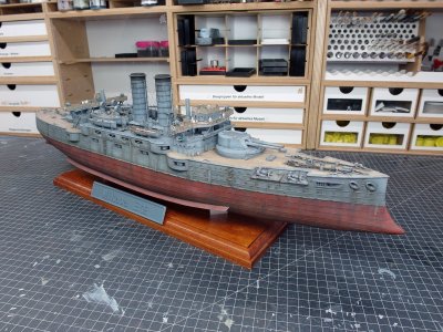

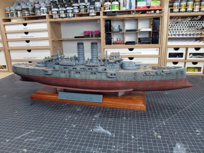

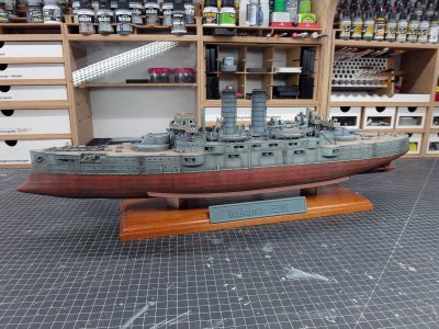

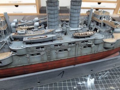

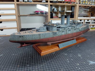

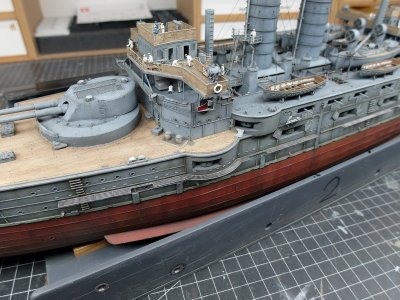

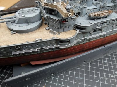

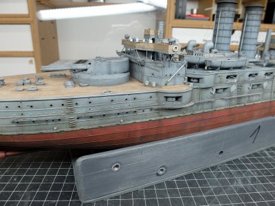

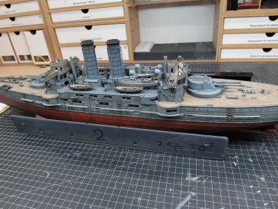

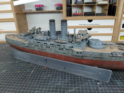

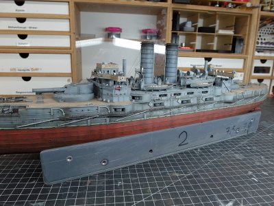

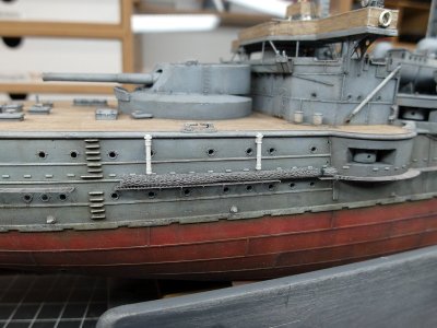

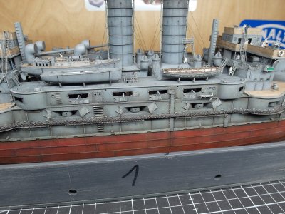

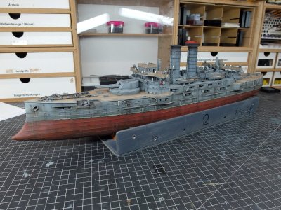

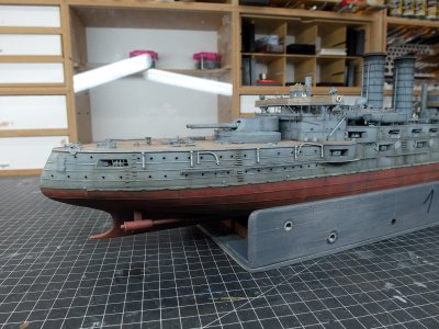

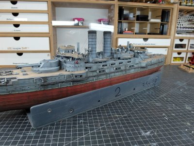

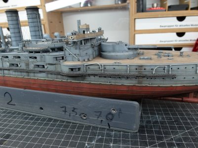

To that end, I've removed the model from its assembly stand, as I want to modify it slightly for the next steps in the hull construction.

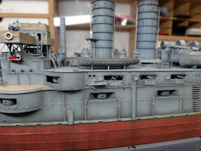

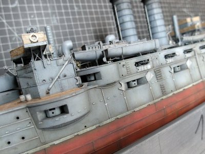

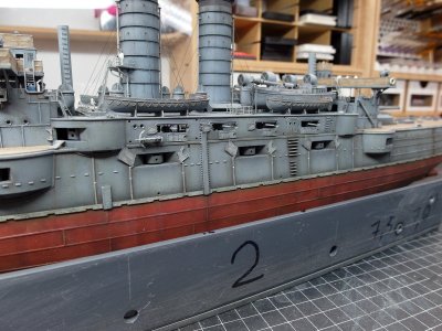

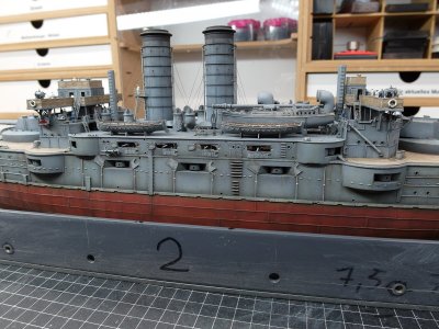

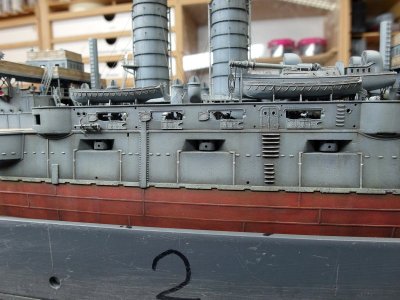

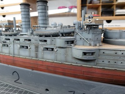

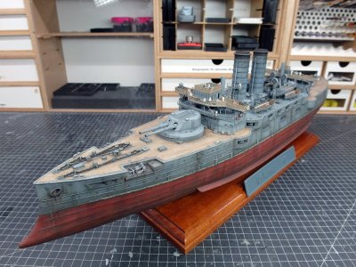

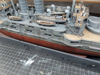

I took this opportunity to take some photos of the almost finished model on its final stand.
I also had a very nice name tag made by the company ModelMonkey, which was even attached for a test fit.

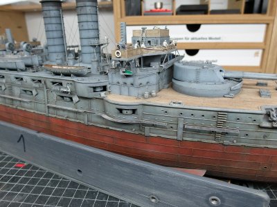

There’s still quite a bit to do on the outside of the hull. I’m already dreading installing the gallery at the stern.
Man, the silhouette of that ship is really great.
I especially like Mikasa from the front. As if she wanted to impale her opponent.
So, dear community, I’m just adjusting my assembly stand now, and then I’ll take a short break because I have some personal matters to attend to.

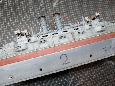

Hello fellow model builders.
I’m back at the workbench. The short break is over, and I’m excited to begin the final phase.

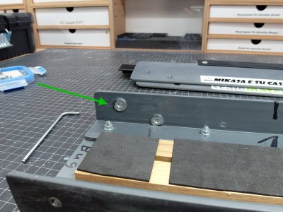

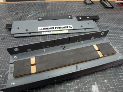

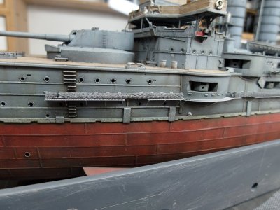

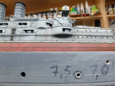

First up are the remaining details on the outer hull. To make this easier, I’ve modified and expanded my assembly stand a bit.
I will frequently need to open it from one side in the near future to attach components to the hull. For this purpose, I acquired sleeve nuts and glued them into the stand in place of the regular nuts. This makes opening it much easier, as I no longer need to tighten the nuts against each other.
Furthermore, I’ve enhanced the protection. The installation of the torpedo nets and their supports is next. These extend quite far back, especially at the stern. Therefore, I’ve mounted an additional bracket to protect them.
But let’s get to the model.

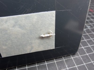

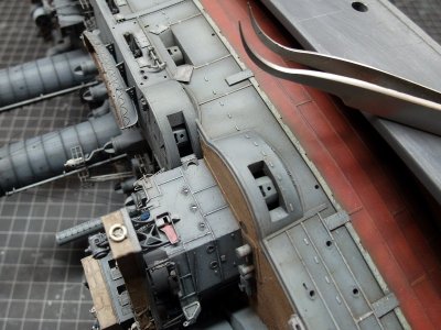

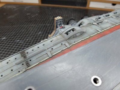

First, I assembled the small anchors in their holders. To do this, I attached the photo-etched parts to a piece of adhesive tape and inserted the anchor into the holders. This makes it easier, as gravity helps. Then I attached the locking mechanisms on top and let it dry.
The same system applies when attaching the anchor to the hull. If the model is lying on its side, the acrylic adhesive sets beautifully because gravity holds the component in place.
And now he’s where he’s supposed to be.

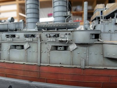

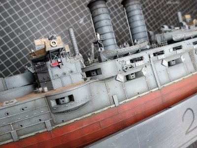

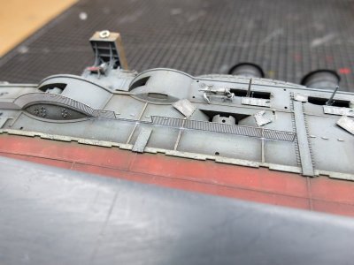

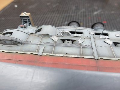

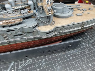

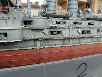

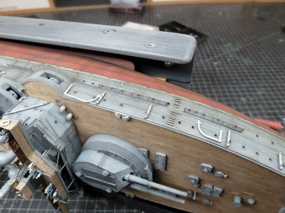

The side covers of the upper casemate guns were still missing. Here too, it helps immensely if the model is lying on its side so that the covers can be aligned at leisure.
This completes the port side, and I can easily and quickly close the side again using the new sleeve nuts and install the same on the starboard side.
The re-entry is therefore complete. Thumbs-Up
A quick Sunday update.
Opening and closing my work stand works very well, as expected, and thanks to the sleeve nuts, it's now very quick too.
This makes it incredibly easy to simply switch sides and lay the model on its side for easier lid installation.
It simplifies things so much. Especially since I don’t need to use superglue, as the acrylic adhesive has time to bond due to gravity.

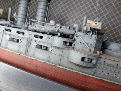

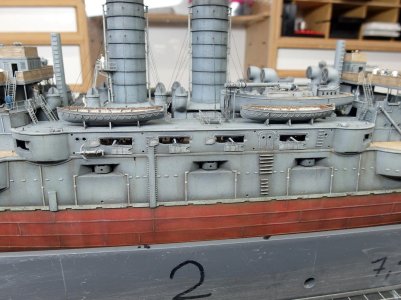

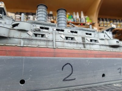

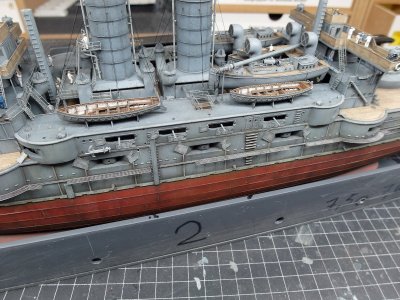

More and more of the covers on the casemate guns are taking their place.
I can only attach the lids that open downwards once the support with the torpedo net is secured, since they rest on the net.
The lid with the radius on the upper, outer round casemate will be added later. It’s too prone to being torn off. And I need to check the space available between the net and the lid on the lower round casemate first.
And just like a pit stop in Formula 1, I simply closed the dry dock and switched sides. Great.
And the Mikasa was laid on its side again.
The anchor is now in place on the starboard side as well.
Great, that worked well. The torpedo net can be installed.

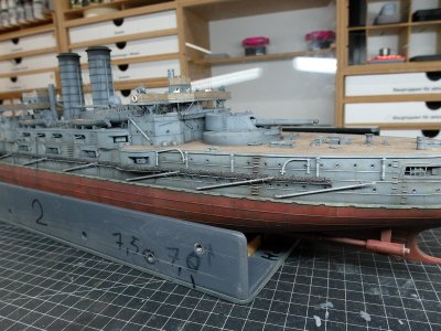

On to the next hull detail.
The torpedo net supports need to be attached. It’s a delicate job, requiring great care not to bend the finely detailed components.
And this task, too, is made easier by my assembly stand.
Once again, I can use Mig’s acrylic adhesive to attach the components and don’t need to use superglue. Diluted with water, it flows beautifully into every gap.
And it leaves absolutely no residue.
The result is mesh supports that run perfectly parallel to the structures on the hull.
Clean and without adhesive residue.
Now the supports can be attached.

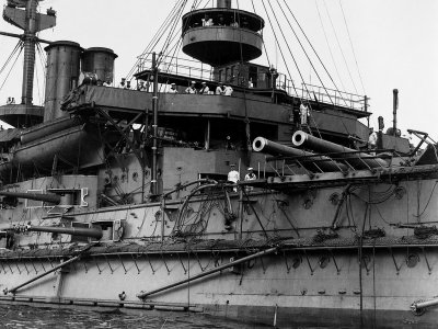

In another forum, a user asked whether the arrangement for the spars actually works. On the Pontos model, they extend very deep into the cradles.
That probably isn’t quite right. I have a picture here of HMS Magnificent, which is quite similar to my Mikasa. It shows that the spars were secured further forward—ahead of the supports and the nets.
To this end, they were likely seated primarily in their mounts and secured with a steel cable—as seen here on the SMS Goeben.
I think that is exactly how I will do it.

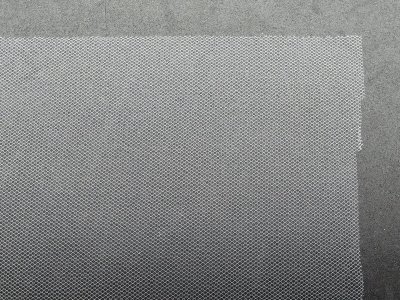

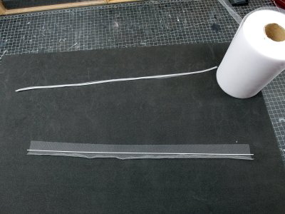

Let’s move on to the material I am using for the nets. These are to be represented using tulle fabric.
I think the mesh size should be fine for 1:200 scale. I ran a quick test and laid them loosely onto the supports. Once painted to look like steel, I’m actually quite pleased with them.
I’ll have to roll a sausage long enough to be able to show the mesh continuously. But I’m already very pleased with the first test run.

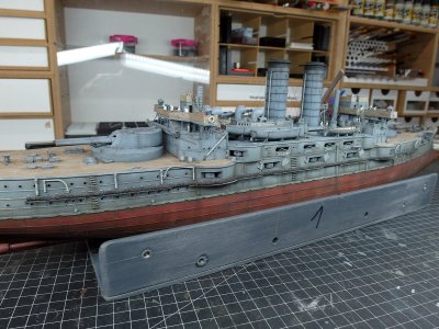

Let’s do a quick update on the starboard side.
I had to attach another 50 small, thin supports. Anyone who used to enjoy playing Pick-Up Sticks has an advantage here.

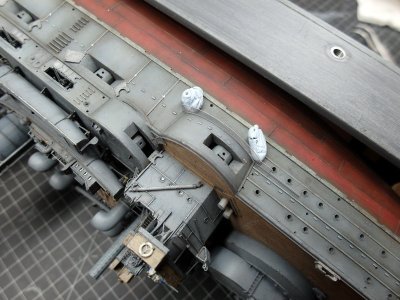

But first, the overlay itself. To hold it in the correct position while the adhesive sets, the blue putty from “Blu Tack” is perfectly suited.
And so, on this side as well, the torpedo net sections gradually take their place.
And towards the bow.
The next piece of intricate detail work is thus complete.

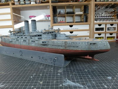

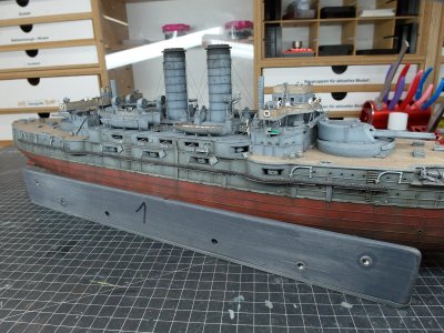

Another quick weekend update.

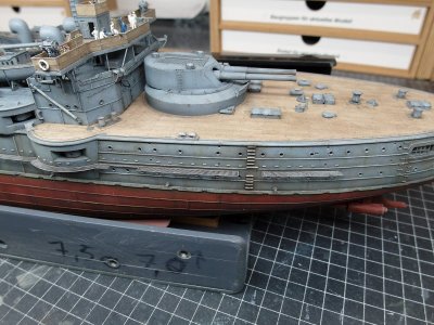

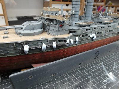

I have processed the parts for the davits located on the exterior of the hull.
I wanted to have them installed before laying the net, since everything seems to be getting very tight again.
So the girl was laid back on her side.
No big deal.
At the bow, the lowered davits.
And, of course, portside.
Now the net can truly be laid out.

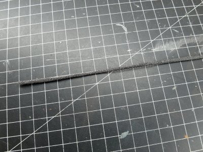

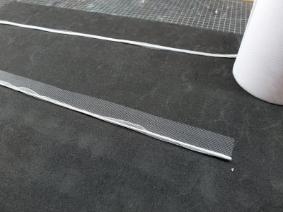

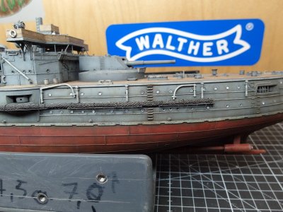

But let’s take things in order. First off: making the net. To do this, I sourced a roll of tulle fabric online, which features a truly excellent mesh structure. After a few test cuts, I determined the optimal width to ensure the net wouldn’t end up looking too thick.
Now it just needed to be rolled up neatly—a task that proved more difficult than anticipated. The secret to rolling a tidy “sausage” lay in using a long styrene rod; this allowed the tulle fabric to be properly shaped.

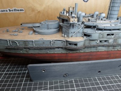

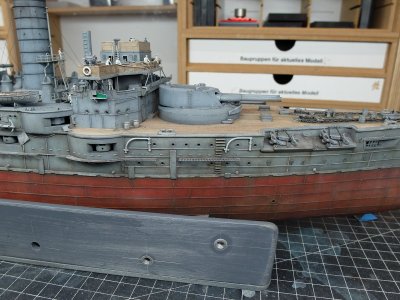

Next, I brushed it with Vallejo Metal Color’s “Steel” paint, and the torpedo net was finished.

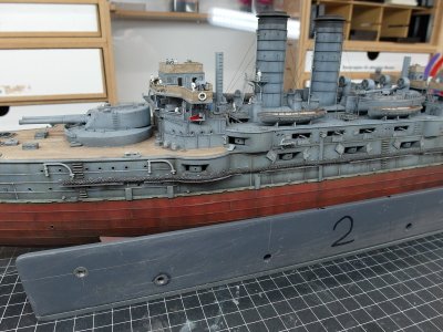

Now, all that remained was to get the whole thing onto the stands. As you might have already guessed, my assembly stand and Blu Tack helped me out tremendously.
And so I keep working my way forward.
The most difficult parts were the sections around the round casemates. But even there, the blue putty came to my aid.
And so, the torpedo net now rests quite presentably upon its support.
Now, do the whole thing again on the other side…
…then ropes and spars can be attached.

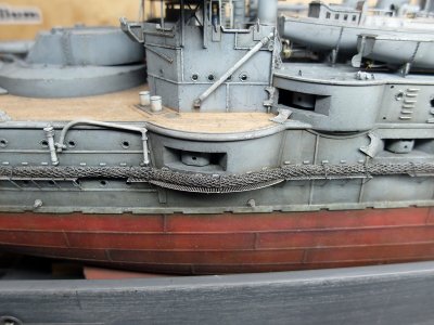

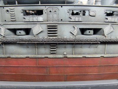

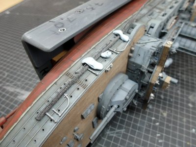

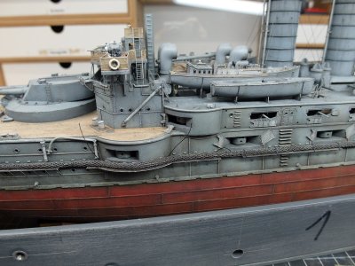

Let’s move on to securing the torpedo net, which on the Mikasa was fastened to the supports using ropes.
It is only a minor change to the model’s appearance, yet time-consuming to execute. And, of course, essential for completeness.
So, I spent two days stringing lines. First, I tacked the thread behind the net with a tiny dot of acrylic glue.
Then I took the blue modeling clay again and stretched the yarn over the nets to hold them in place. This gave the glue time to set.
Then the thread was cut, folded over, and glued down. The result looks like the ropes that hold the net in position in the original photos.
I think that comes quite close to the original.

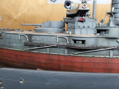

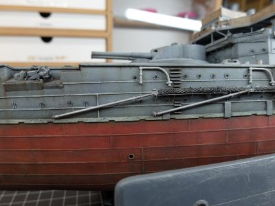

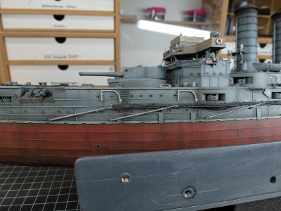

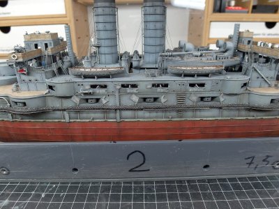

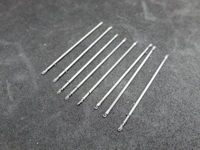

Let’s move on to the aforementioned spars.

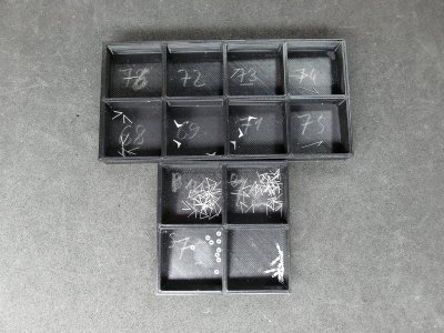

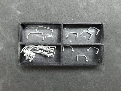

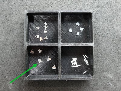

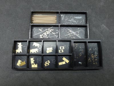

For the next steps, I once again cut everything out—as is my usual practice—and gathered the pieces in my organizer trays.
Even the spars from Pontos consist of five parts and are damn close to the original.

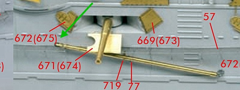

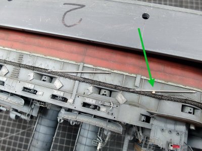

I have to use a bit of a workaround to attach them. The Pontos instructions simply show them resting on the supports right next to the hull; however, with the netting in place, they end up quite far from the hull wall, so I have to adjust the mounts.
Using a small wedge—the cut-off end of a toothpick—I can easily hold it in position until the acrylic glue has set.

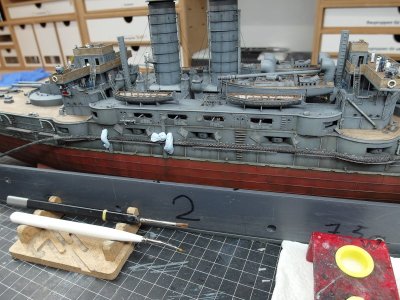

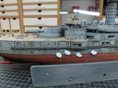

I’d almost forgotten that it was high time to glaze the portholes. If I added any more details, I’d run into trouble doing it later. So, in go the Micro Kristal Klear drops.
Next, I modified the spar mounts. Since they now projected further from the hull than Pontos had intended, they no longer reached the hull surface. I therefore shimmed them with a piece of styrene profile. See arrow.
This restored the correct distance between the mounts and the hull surface.
And so, I work my way toward the stern, bracket by bracket.
And just like that, the eight port-side spars are installed.
