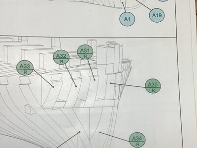

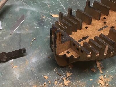

I have the feeling, that the manual / drawings were produced during a different period than the modelMy apologies for resurrecting a year-old thread, but I acquired this kit not long ago from my LHS and I have a question for anyone who may have had some experience with it.
I will first say that up to this part of the build, apart from some mis-labeled parts on parts listing, the kit has been absolutely splendid and the fit of the parts is extremely precise. Would have been nice if the part numbers had been laser etched into the larger parts, as it would have saved a fair bit of glancing back and forth between the parts and the parts lists. No biggie. So my question is this: In the instructions, parts A30R and A30L are slightly shorter than the ppost rising from the keel, but when dry fit, the are clearly much taller.
View attachment 267398View attachment 267399
It appears those parts just need to be cut off at the first step, but given my limited experience with wood ship building and the precision with which everything else has fit together so far, I am reluctant to start hopping up parts without first hearing from someone who might have already dealt with this.
Thanks, everyone, in advance!
Hello Namabiiru. I am tagging the manufacturer of this kit, Maria is represented by Falconet @Falconet manufactures. Her native language is Russan, but she understands English and might be able to help you obtain the latest manual or help acquiring missing parts (if any).My apologies for resurrecting a year-old thread, but I acquired this kit not long ago from my LHS and I have a question for anyone who may have had some experience with it.
Thank you, Jim. That will be great if she is able to respond. Perhaps she will also know if the photo etch grill for the skylight is available for purchase as a seperate add-on.Hello Namabiiru. I am tagging the manufacturer of this kit, Maria is represented by Falconet @Falconet manufactures. Her native language is Russan, but she understands English and might be able to help you obtain the latest manual or help acquiring missing parts (if any).
