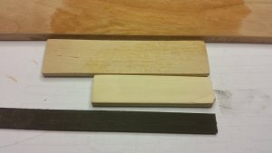

I have made a sample of birch, stained with black water-based stain thinned 50% water and added two coats,
bottom of the picture and it is without oil or wax.
Cherry
Birch
Holly
Black birch
