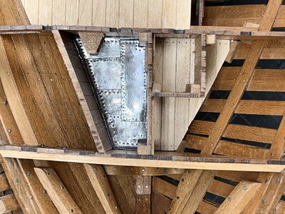

I used for the cladding inside the powder room sheets of lead - take a look and please check also the discussions afterwards, where friends suggested alternatives to the lead

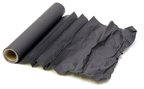

f.e. I bought some of this foil, which @Jweb mentione - I am pretty sure, that it will work also and amybe better than lead (have to try on my next model)

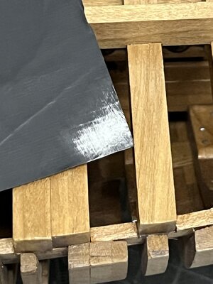

Thank you for all the suggestions, what I finally went with was a sheet of .04" silicone rubber, this molded nicely to the contours of the hull and puncturing it with a pointed piece of metal left marks that resembles rivets.
