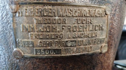

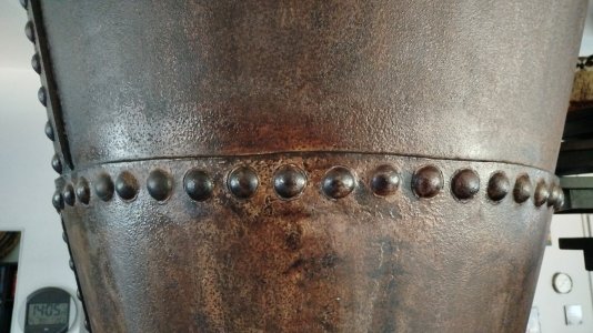

For all of us looking foreward to deal with rivited iron/steel in a bigger scale here an example of a original cylindrical hopper from 1923 built in a Saxonian iron works factory:

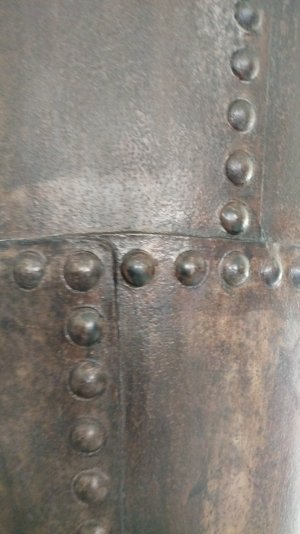

The plate joining in frontside view clearly shows the inregular edges of the plates:

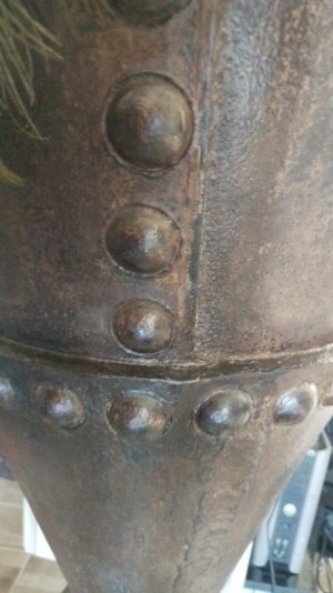

An upside view to the joinings of three plates:

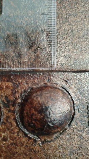

The scale of these rivets in millimeters:
Hope this helps to end into the faith of todays' standards of exact edges and so on - it is craftmenship's work without laserguided CNC-accuracy.

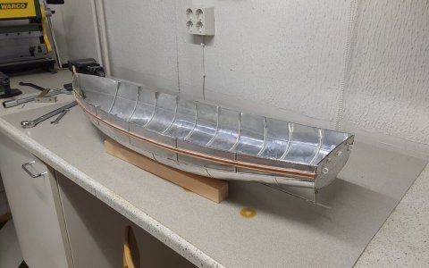

In a few recently made models I have tried to imitate riveted metal plates by covering the hull with plates made of soft 0.2 mm aluminium foil where riveting is pressed using a tool made of suitable gear.
