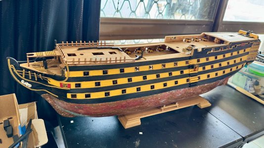

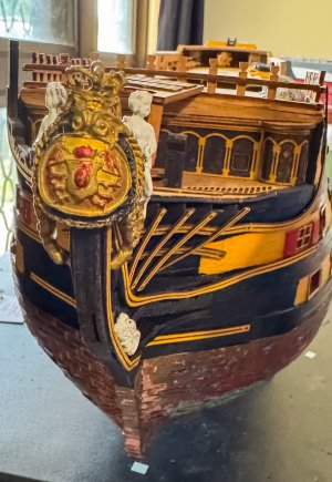

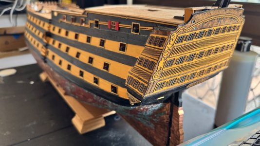

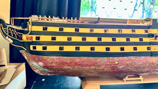

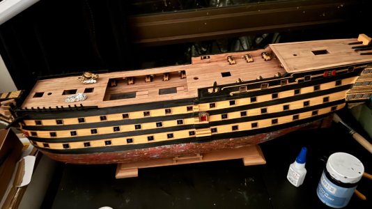

I looked at the photos of the work done previously and noticed something that definitely needs to be corrected. The white painted frieze glued to the bow is part of the stern decorations! In my opinion you absolutely need to remove it and place it correctly.
Yes. I’ve already noticed that.
It’s glued in well. Not sure why they glued that on the front.
