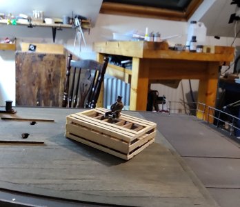

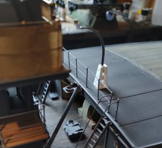

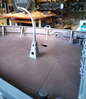

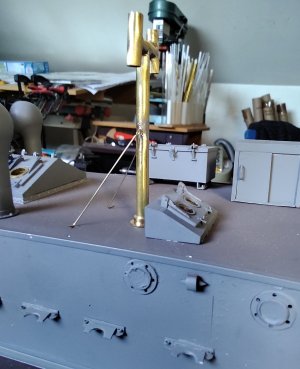

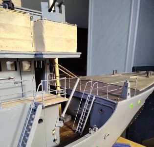

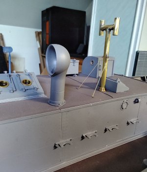

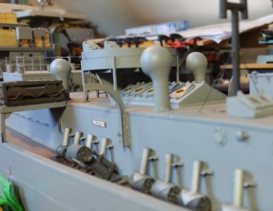

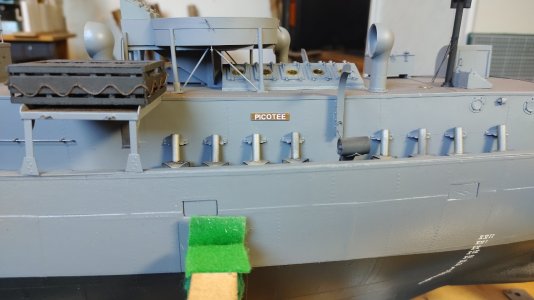

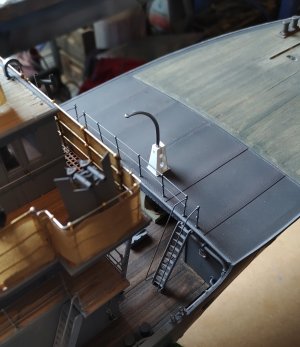

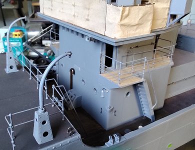

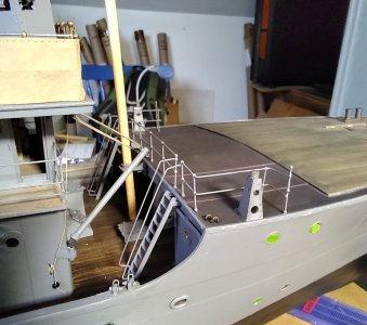

I was hopeing that I would have been well down the line in adding the boat decks by now but I am still waiting for some 'H' profile styrene from Evergreen. Normaly gets here in two or three days. At first I thought that the whole European market had been cornered by a Master Model Maker from the Netherlands, but it turns out to be just more government bureaucracy! I live in Northern Ireland a long time part of the United Kingdom but seperate from Ireland for a hundred years or so. Ireland is part of the EU but the UK left the Union during Johnson's Conservative reign so now they have decided that any one on the main land selling into NI must fill in custom declarations, not unexpectantly modelshops and ebayers are not too keen to go to the trouble for a small order worth only a few bob. Thanks Boris, internal passports like the old Soviet Union next no doubt.
No matter I have made some progress, adding yet more railings to the forecastle but before the could be placed I had to make some small derricks/davits that sit up there They are based on a box like tappering strcture and sit on the stern corners of the forecastle and a third inbetween them, it is used to lift ready use ammunition while the othe rtwo are for stores. I have never seen a photograph of a flower with a davit erected on both sides at the same time, so one less to make.
I have also finished detailing the front of the wheel house block and started to add the galley sky light and stove pipe a bit scrappy yet but will be good in the end.
Hopefuly boat decks next.
Some pics.

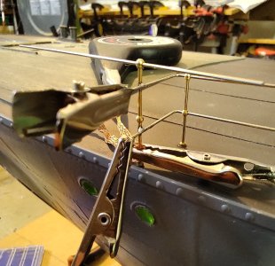

P.S. The funny pic of me soldering the rail is to demostrate my attempt at model making suicide, soldering super conducting brass that is attached to a styrene deck is not advisable but fortunataly the pure copper strip conducted the heat away,phew!
Some pics.

Nevertheless you have added nice details again. A hot soldering iron near styrene: you must be ki(ll)(dd)ing ......:oops:ROTF

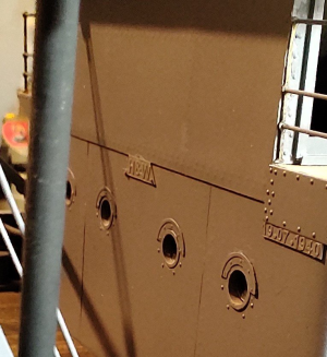

çivi efecktlerini nasıl yapıyorsun??
Hello Oktay.
The large ones are 3D printed and the small ones are made with a neurologist's wheel pushed into the reverse side of the styrene.
Büyük olanlar 3D yazıcı ile üretilirken, küçük olanlar nörolog test tekerleği ile üretiliyor.

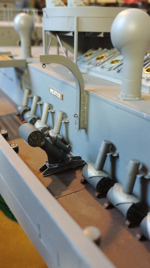

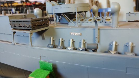

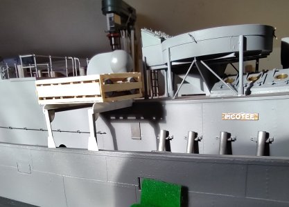

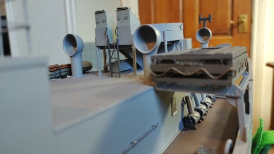

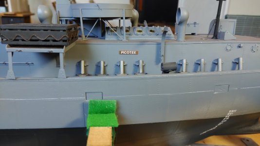

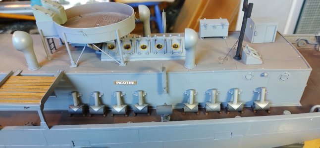

I now have all the material gathered up to build the tricky boat decks that connect the main superstructure to the gunwales, but the more I thought about it the more I realized it would be easier to add some more of the detailing that runs either side of the engine casing beforehand. I started with the supports for the rafts. I already had a carley raft painted up, but I had to build the six barrel raft. This was easy enough as it is very similar to the ones we built as wee wanes to have raft races in Carrickfergus harbour, six oil drums and a few busted pallets. Back then ours where held together with string and nails and would fall apart with the swell from the Liverpool boat. Hopefully the real thing held together better.
The depth charges davits over the DC throwers where made and attached but ave sill to be rigged. The DC.s where all painted up the same but different if you know what I mean, as where the carriers. The DC's wooden deck supports where all fitted but I still have to tie everything down. It doesn't look like much but it took me over a week to get this far. At this rate H&W will have built the real thing quicker than I have this.
Some Pics..
IMG_20250404_231858.jpgIMG_20250406_090251.jpgIMG_20250408_181036.jpgIMG_20250408_181044.jpgIMG_20250408_181140.jpgIMG_20250408_181148.jpgIMG_20250408_181213.jpgIMG_20250408_181225.jpgIMG_20250408_181241.jpg
