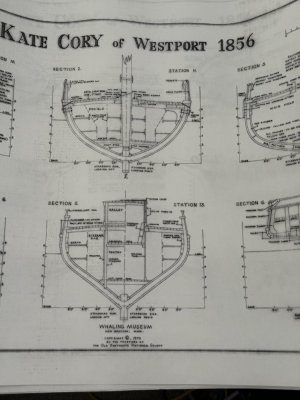

The whaling museum in New Bedford used to sell a set of 5 sheets that are much more detailed than whats in the Model Shipways kit. I’m nearly done with my Kate Cory, so might be able to pass the plans along… Crappy phone pic here: IMG_7752.jpeg
Unless you are intending to build an unplanked open framed model, which, as indicated above, apparently poses unsolvable problems with historical accuracy, thereby generally negating the purpose of an open framed model, the rough-carved hull blank from your Model Shipways "Yellow Box" vintage kit is a far easier option for hull construction. In my experience, which goes back to when they were made, those hull blanks are very close to being accurate right out of the box. They usually need little more than a sanding to fair them to the lines. Some shaving is required to thin the bulwarks on some of them, as is refining the bow, sternpost and keel. Other than that, they're good to go. If you want to show plank seams, those can be scribed into the solid hull or it can be planked with thin planking of wood or card stock. However, at the scale (1/8" IIRC,) plank seams would not be visible at scale viewing distance.
The whaling museum in New Bedford used to sell a set of 5 sheets that are much more detailed than whats in the Model Shipways kit. I’m nearly done with my Kate Cory, so might be able to pass the plans along… Crappy phone pic here: View attachment 521483
Thanks for that offer. Let me know when you finish and we'll figure out how to connect.
