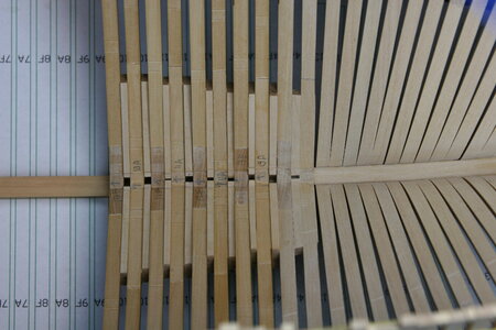

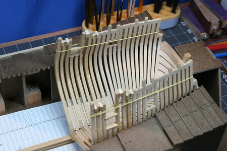

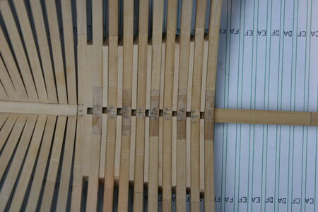

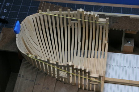

Anyway, I have added some square frames both fore and aft:
As you can see above I have chosen to add filler pieces at the base of the frames alongside the keel. I have seen these omitted on several swan class builds but I like the look so I am adding them. I suppose I could just install them on the port side which will remain unplanked - but I was worried I would end up introduce a warp or bend to the keel that way. Plus, it's not really that much more work to make two fillers versus only one.

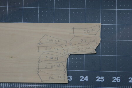

The downside of adding these fillers is that the space between frames varies from frame to frame along the length of the ship. This means each space requires a custom thickness for the filler:

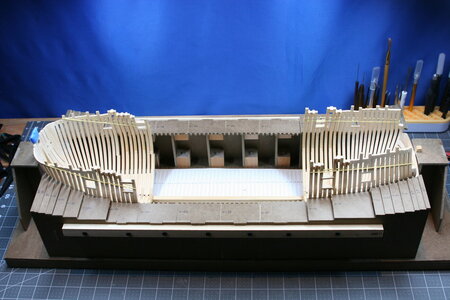

Oh, one more thing slowing me down...repairs and do-overs (notice the scabbed in block on the frame where notches were cut incorrectly for the sills):
