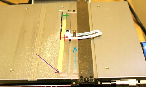

Second: I think I do nee more than one hour to understand how this angle gauge ..... :eek:
On your photo the end of this cut plank is smaller (green width) than the width where the blade is in moment (red).
I guess the complete gauge is moved along the blue arrow, the wooden strip is fixed at the gauge (purple arrow) and moved together towards the balde.
Wouldn´t it be not, that first contact with the balde would be the widest part of the plank and at cut would be getting smaller and smaller.
I am asking really only to understand the working of this element - sorry for my english - I am terrible in formulating such things, but I hope you understand my problem in understanding..... hope so

And then I used a power tool for the second time in a month! This is a Byrnes table saw with an angle cutting accessory (only took me an hour to figure out how to use it ROTF) (Full disclosure: one hour for the table saw - one hour for the taper gauge.)
As I have mentioned previously, I have an unhealthy (nearly crippling) fear of power tools that cut my fingers off...

First of all very good and pricise work on the wales-elements - BRAVO
Well, there is a very real possibility that I am using the tapering gauge incorrectly (maybe I needed two hours to study)! I'm not sure if anyone has ever noticed before but power tools only come with SAFETY instructions not HOW TO USE THIS THING instructions.
But yes, I slid the entire jig toward the blade exactly as you have described... If someone has a better (safer!) way to use this jig please teach me how!!!
The reason the green part is narrower than the red part is that this is the second cut on this strip of wood. The top/butt pattern has a long side and a short side - the green represents the short side (already cut) and I am about to cut the long side.
Your English is better than my German... :rolleyes:
