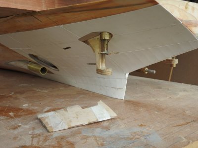

I’m also working on a steel hulled ship building plank on bulkhead. But how to make it smooth enough to look like metal? Photographers foil? How big would the individual plates be? Try to simulate rivets? I’ve always built wooden hulled ships but this is new to me. Thanks. Lou

Lou,
Your best option is to plate the hull. Wood naturally expands and contracts over time so these hull planks are likely always to be with you.

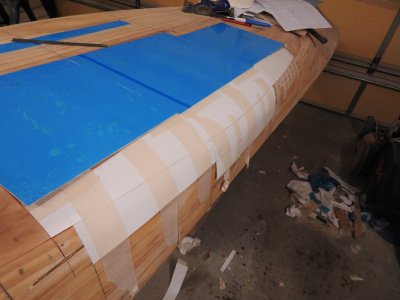

I would suggest paper. Invest in some high quality acid free paper. It is easily cut into plates with a guillotine type paper cutter (a surprisingly useful tool for the model shop). I first paint the plates with a coat of shellac and let it dry. The plates are then easily glued onto the model with your favorite PVA glue.

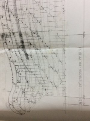

Shipyards were furnished with a plating expansion plan. (First photo). I’m assuming that you don’t have one of these so some guidance:

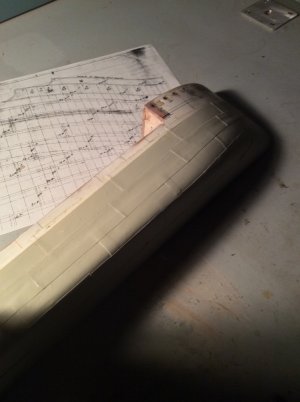

First there are two types of plating depending on the way it was fastened; Riveted and Welded. If your ship was built before WW II it was most likely riveted. The plating seams of a plated ship are lapped and are a distinguishing feature. (2nd photo) Don’t worry about showing rivets. The plating seams of a welded ship are butt welded so are invisible at any scale viewing distance.

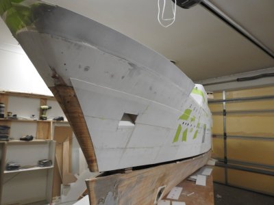

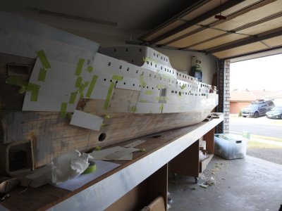

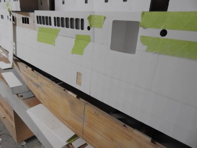

Lou to demonstrate welded plates in styrene. and yes you can form in 3 directions by heating and stretching over the hull by hanging counter weights on sheet styrene. But this demonstrates the realism that can be achieved, weld seams and weld distortion to done with a pizza wheel on the back of the plate on a hard rubber mat.
Good Cyano is imperative, I only found Starbond to be any good, and it does not come off trust me.
After weld bead are glued into edges.
3d Formed plates on bilge, no bubbles or burn through
