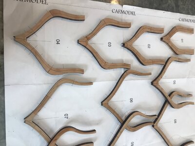

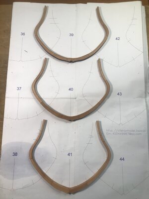

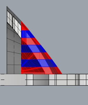

Finished up the last 2 midsection frames. so 15-45 are complete. Leaving the Bow and Stern frames. Next on the agenda is the Hawse timbers. Built the Jig, and will sand and dry fit the timbers tommorrow. CAF has done a nice job of marking the interior bevel lines, for proper interior angle. This will be critical for the addition of the full internal structure.

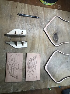

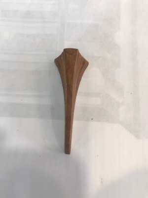

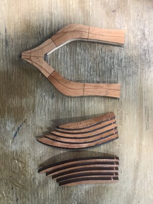

Built the Hawse timbers and beveled the interior only. Also built Frame 1 to get an idea of the fit of the Hawse timbers between Stem and Frame 1. Asked Tom at Caf for some updated photos of his models bow, as some serious beveling to frame 1 both interior and exterior is needed.

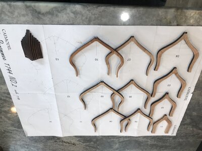

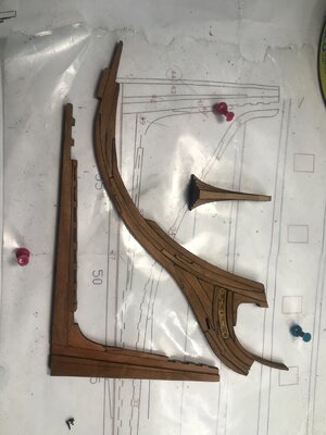

Received my missing part from CAF, so dry fit the stern post, and have completed 10 of the 14 bow frames. No beveling or sanding yet, as I want to dry fit to the Stem and Keel First
Good morning Paul. Great craftsmanship. A lot of work to get all those frames looking spot on. Hawed timbers are amazing. It is going to be so cool when you complete the fitting of these frames. Cheers Grant
Получил недостающую деталь от CAF, поэтому насухо подогнал кормовую стойку и закончил 10 из 14 носовых шпангоутов. Пока никаких скашив или шлифований, так как я хочу сначала высушить ножку и Киль.

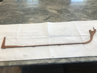

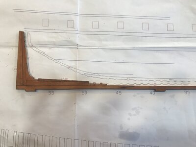

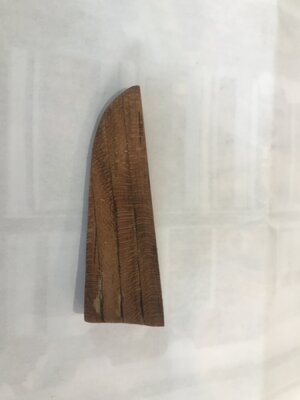

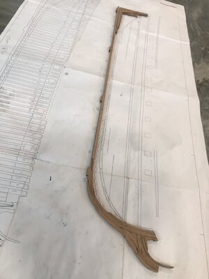

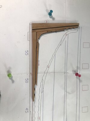

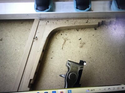

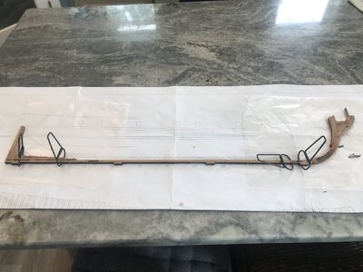

Today, did some fine tuning on stem and stern, light sanding and some touch ups on joints, dry fitted the stem-sternpost-keel, Glued stem-sternpost-keel using blackened titebond to highlight joints. Also, built the sternpost fillers, which go between frame 57, and the sternpost knee.l
Kurt. check page 2 of this log, I have a picture of what I use, Its Titebond Quick and Thick Glue, and SOHO black graphite powder. I just mix the 2 together on a sheet of waxpaper till I get the desired color. Then I use a paint brush to apply to the joints. I apply a little more than needed so it oozes out a bit when clamped. Let dry, trim excess with exacto blade, then sand. The Poly or varnish will really highlight the joints when applied. Thanks for asking, and the Likes!

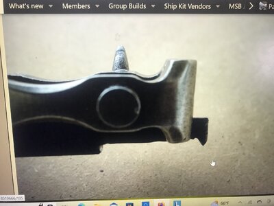

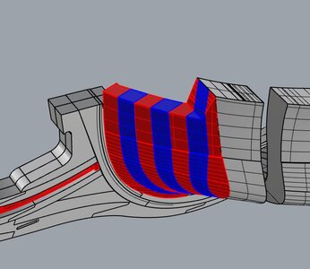

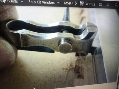

Luis, in researching, it appears to be an attachment for a CNC mini milling machine,,,,which the price overshadows my need....
I agree with you Paul.
I will try to make a mini milling tool to use in a rotary machine like Dremel. It will be necessary to use a metal bar as a guide and a lot of practice to make the curves without damaging the model. Let's see !
Hi Paul,
You don t need fancy over priced tools, just use a razor blade of a few cents and shape it to your needs.
See my blog here.
Hi Paul,
See my blog here.
