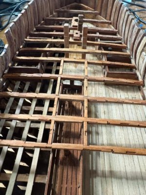

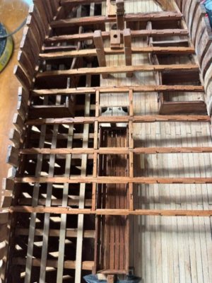

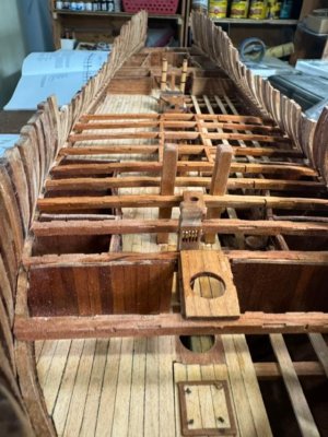

So...after a long hiatus, and 2 smaller models....back at La Renommee. Started Section 5, attached Frame supports for Gun Ports, started laying out deck beams for bow. Direction are a bit confusing, but it appears the deck beams should be laid and measured by section Bow-Mid-Stern to ensure measurements for mast supports and carlings are correct, and then fill in the rest of the beams.
Installed Beams 5C1-5C3 and 5D1, also built and installed the Fore Jeer Bits(directions confusing here, its actually to the right of center, not centered. The ANCRE book is a huge help on proper placement of pieces. Still not happy with some of my notches.......
