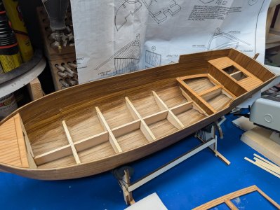

making progress on the final layer of planking. I got good input for my next build about making the length of the planks more to the scale I was building it. I also had never done a rabbet. Now I have read up and know what I have to do the next time. I figured out if you don't do it before planking your can't go back and redo it. Oops!! Still learning. I am getting the fit of the planks much closer and not leaving a lot of gaps to deal with.
This is the final layer all in. Time to sand and finish the planks so I can begin applying the linseed oil before going on to the next steps. It is really easy to say, I'm going to sand the inside and outside of the hull. About 10 pounds of dust later I think I've got the finish down to a really soft feel. Started with 120 grit and worked my way up finishing with 800 and 1500 grit. I did not sand the inside planks below the floor line as they will be covered in the final parts of the floor assembly.
OK, this catches you all up to my work as of this evening (9-12-25 at 1:30AM) I have the first coat of linseed oil on. Waiting for 20 minutes to do a light wipe over it and then it has to dry for 24 hours. I'm thinking I will be putting 3 layers of linseed oil on the hull before I go on to the next steps. I'm going to check and see if the flooring elements are also to be finished with linseed oil. I may go ahead at the same time and do those as well so they will look good when installed.

I will post more photos later today. The second coat of linseed oil is dry so I very lightly sanded the hull with 1200 grit sandpaper. It felt like glass after that sanding so I applied the third coat an hour ago. I have also prefitted all of the deck pieces and then laid them out and have applied two costs of linseed oil on them as well. I think I will stop at the fourth coat of linseed oil on the hull. Pictures later.
Well, after three coats of boiled linseed oil, a light sanding with 1500 grit and 48 hours drying for the third coat i think I'm done with the finishing. I don't think a fourth coat would add a lot. I also applied three coats of linseed oil to all of the deck sections so I could go ahead and get them installed. making progress.

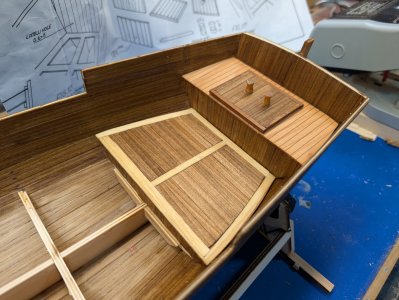

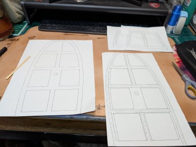

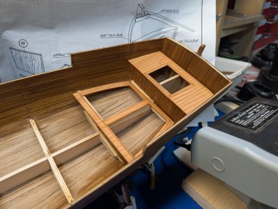

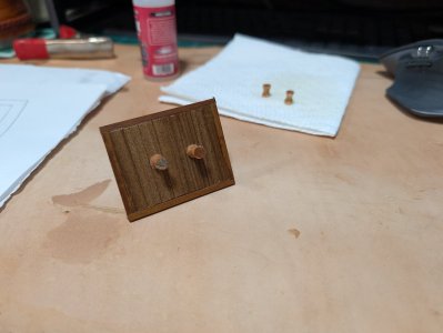

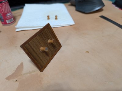

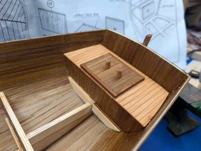

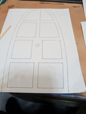

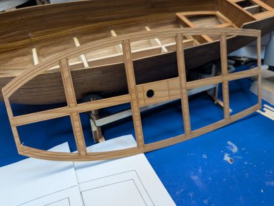

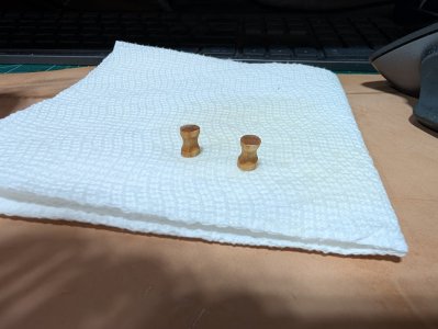

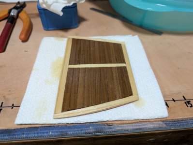

Well, I'm finishing the stern deck hatch cover. The one that came with the kit seems a little off so I planked it to add depth and will use the planked side up. I used a 6mm dowel rod to turn and make the tie downs on top of the stern hatch. After I glue it down I'll go on to the foredeck door hatch and finish that section. I also traced the outlines of the deck shutters so I can use them as template to make the planking. Once done and shaped I'll attach and fit them onto the deck. then I'll fit the deck onto the bulkheads. I've already pre-fitted the deck sections and made them nice and close on the finish so it should drop right in once all of the shutters are in place. I wanted to do it this way so once all of the shutters are on the deck, I can sand it easily while it's out of the hull. Then on to the stringers I think. The second stern deck section looks misaligned but not to worry, I haven't glued it down yet. Once the shutters are on it I'll glue it in place.

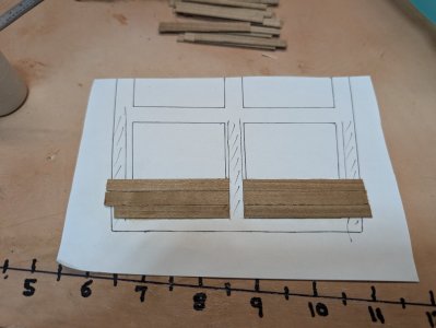

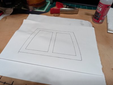

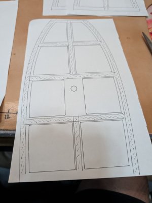

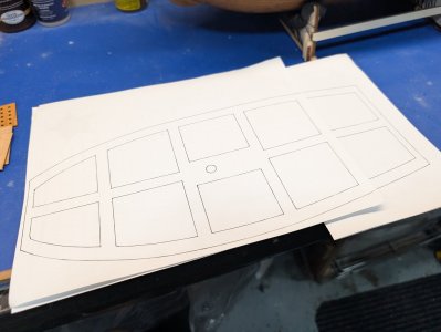

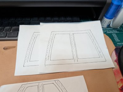

Working on bottom deck level now. I am using the hand drawn template I made from the deck to cut the shutters and fit them in place. I'm making sure the inboard line and the stern line on each shutter is lined up closely. When I get them all on, I cut the duplicate template I made and use it to mark the trim lines for the curvature. Worked well on the middle deck so I have great hopes for the rest of it. Just really slow until I get my hands under control. Seems like the more I work the less they bother me. Doing this really helps a person relax!! I am putting two coats of boiled linseed oil on each section as I finish it. I think it really looks good! More later!!

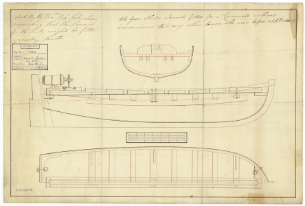

In spite of what is written on the box, assuming this is an armed, (not armored :),) British launch, the drawing below from 1795 at RMG might be useful as well. If it was indeed armored, that would be really interesting.
