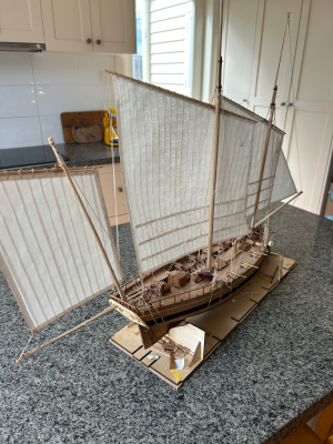

I have now made the yards:
The rings for the fore main and mizzen mast hold the sails in place rather than just relying on the halyards. They’re made from 0.8 mm brass wire with soldered joints.
Here are the foresail and mainsail completed and on their yards:
Kind regards
Salty
Here are the mizzen and the jib
The lines at the foot of the mizzen are attached with tiny toggles. I’m not sure if this is accurate but I thought using bowlines looked a bit out of scale. The line on the jib halyard is attached with a hook.
The deck is still a bit of a tangle of lines, but I think I will trim some the standing rigging (mostly shrouds) off short where it is cleated. The halyards would have been very long as Le Coureur used a tackle system to hoist the yards which you can just about see on the photo of the mizzen. I might just coil them on the deck.

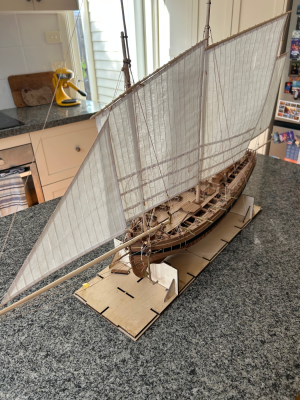

The foresail and main sail are now on Le Coureur:
The process was relatively straightforward in the instructions but like all things modelling, some care is needed to get the right result. I played around with the lines to make sure they were tight, but not overly so, and that the yards were slightly angled.
Another small complication was having to remove some of the shrouds to fit the rings on the halyards under the standing rigging.
Kind regards
