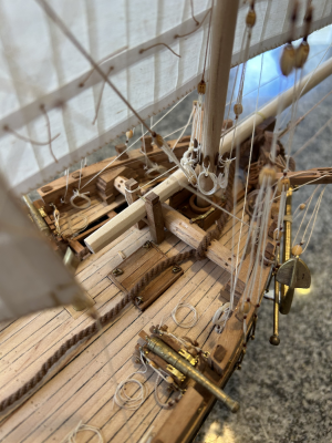

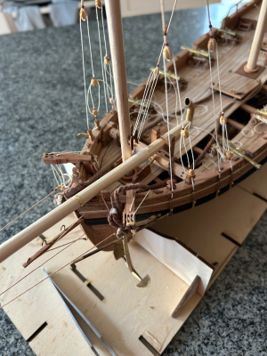

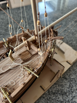

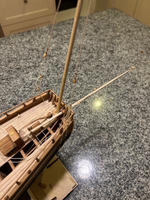

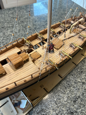

Over the last few days, I have been rigging the bowsprit and foremast.
Before installing any of the lines, I had to put small sheaves in the spars held in place with a 0.5 mm brass pin.
I decided to replace the blocks and some of the lines in the kit with ones from Zoly at Drydock. The blocks are very nice with the holes for the sheaves being drilled out and a nice groove down the side that traps and holds the stropping while you tighten it. The remainder of the line is DMC Cordonnet cotton crochet thread which comes is various sizes from 20 (approx 0.5 mm) to 100 (approx 0.2 mm). It comes in balls of about 400 metres, so one order will see me out.
As with the cannons, all the seizings are nail knots. It takes a bit of planning as you can’t tie them on the model, but they can be slid into place relatively easily before setting with glue and trimming. On a good day, I can do about 10 in an hour, but I feel they are worth it.

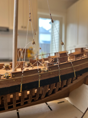

The standing rigging for the main mast:

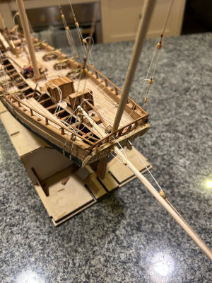

The next step is to make and rig the mizzen mast:
I am starting to get the hang of it now given this is the third time I have done this. The lines and blocks on the mizzen mast were slightly smaller than on the main and foremast.
There’s a bit of tidying up to do now with cleats to be fitted to tie off the lines. There’s also a number of eye bolts to go on the deck. I suppose they were used to secure things while Le Coureur was underway.

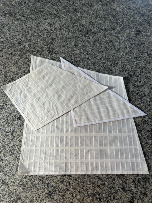

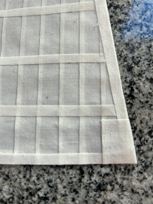

Next up are the sails.
I am using the cloth in the kit as it looks quite good - nice fine uniform weave with no fuzziness - and following the method described in the instructions. I painted the cloth in a mixture of PVA (acid free/ph neutral) and water to stop the edges fraying and then cut into 14 mm wide strips. The strips were then glued together with a 2 mm overlap with some more diluted PVA to replicate the seams. Grease-proof cooking paper stops everything sticking to the bench, but I peel the sail off before it is completely dry. The reinforcing strips were added last.
I haven’t heard of this method before, but I think it looks quite good. After the bolt rope, cringles and reefing lines, I might add some tinting to better represent the colour of canvas. I also think having the fabric slightly stiff will make sewing easier.
Given the size of the sails, it’s going to be a very lofty rig. I can see why these luggers, which are based on “chasse maree” fishing boats, were very fast and manoeuvrable.

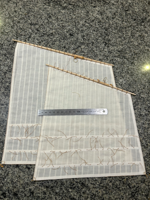

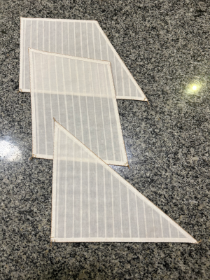

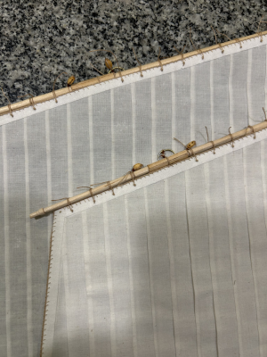

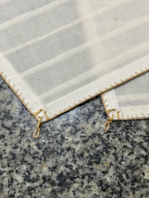

Here is my effort on adding some details to the sails:
The bolt rope is 0.7 mm and the stitching is ordinary 100 weight cotton thread from a sewing shop in town.
I pre-punched the holes, partly to get an even spacing and partly because I wasn’t sure the sail would handle too much rough treatment pushing the needle through the fabric.
The bolt rope is one piece. I tied the eyes roughly in position on the line and positioned them on the corners as the stitching got close. I added some reinforcement points for the eyes as well.
I am no seamstress, but I am pleased with the result. I think they’ll add a bit to the model and I enjoyed the work as they require quite different skills after all the work on the hull.

Paul, it’s just the stitches holding the bolt rope onto the sail. I used masking tape to hold the rope in place while I started stitching and did the first few inches loosely before going back to tighten it up. After completing a couple of sides, I got the hang of it and it was a relatively quick process.

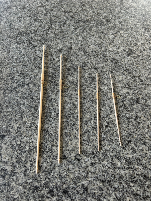

I have now made the yards:
The rings for the fore main and mizzen mast hold the sails in place rather than just relying on the halyards. They’re made from 0.8 mm brass wire with soldered joints.

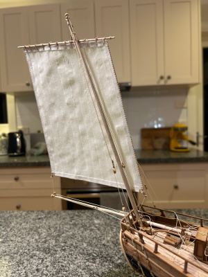

Here are the foresail and mainsail completed and on their yards:

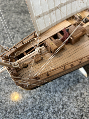

Here are the mizzen and the jib
The lines at the foot of the mizzen are attached with tiny toggles. I’m not sure if this is accurate but I thought using bowlines looked a bit out of scale. The line on the jib halyard is attached with a hook.
The deck is still a bit of a tangle of lines, but I think I will trim some the standing rigging (mostly shrouds) off short where it is cleated. The halyards would have been very long as Le Coureur used a tackle system to hoist the yards which you can just about see on the photo of the mizzen. I might just coil them on the deck.

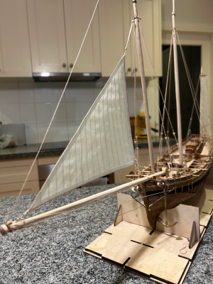

The foresail and main sail are now on Le Coureur:
The process was relatively straightforward in the instructions but like all things modelling, some care is needed to get the right result. I played around with the lines to make sure they were tight, but not overly so, and that the yards were slightly angled.
Another small complication was having to remove some of the shrouds to fit the rings on the halyards under the standing rigging.

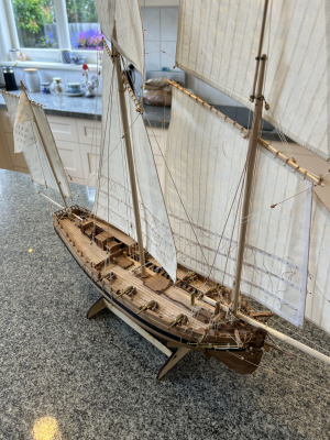

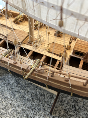

Here is Le Coureur finished
I tried to be a little nautical by tying the lines around the cleats as they might have been in real life - a couple of figure of eights finished with a half hitch.
I made about 2 dozen rope coils for the running rigging mostly. I chose not to use coils for some of the standing rigging on as there is a fair bit of detail already and I didn’t want to overcrowd the look, particularly in the bow. After they were superglued in place, I soaked the coils a mixture of white glue and water to shape them a bit so they look like they are hanging from the cleats.
She took almost exactly a year to complete. I worked on her almost every day except for a long weekend away at my nephew’s bar mitzvah and probably spent in the region of 1000 to 1200 hours in all.
Altogether, it was a very satisfying experience. The kit is well thought out and all the parts seemed to go together as intended. The internal planking in the aft section was the only area where I departed from the instructions. I don’t think it’s an overly expensive kit at about $450 USD and it provides a really nice basis for lots of things like nailing and sewn sails if you want to go that bit further. CAF’s after sales service is excellent as there were some parts missing which were later provided by express mail. There is one criticism which is sometimes made of kits from China concerning the adequacy of the instructions. They provide a basic outline of the steps (a picture or two) and parts involved, but then it’s up to the builder to work out the rest. To me, this is just another aspect of a kit - e.g. pob/pof, wood/plastic - and a prospective buyer just needs to take that into account when deciding to purchase it. Personally, I prefer the challenge of working things out for myself as I think it gives a deeper understanding of the model being built.
