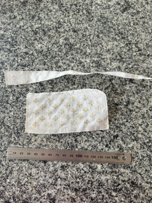

Here is my effort on adding some details to the sails:
The bolt rope is 0.7 mm and the stitching is ordinary 100 weight cotton thread from a sewing shop in town.
I pre-punched the holes, partly to get an even spacing and partly because I wasn’t sure the sail would handle too much rough treatment pushing the needle through the fabric.
The bolt rope is one piece. I tied the eyes roughly in position on the line and positioned them on the corners as the stitching got close. I added some reinforcement points for the eyes as well.
I am no seamstress, but I am pleased with the result. I think they’ll add a bit to the model and I enjoyed the work as they require quite different skills after all the work on the hull.

Paul, it’s just the stitches holding the bolt rope onto the sail. I used masking tape to hold the rope in place while I started stitching and did the first few inches loosely before going back to tighten it up. After completing a couple of sides, I got the hang of it and it was a relatively quick process.

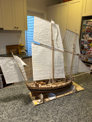

The foresail and main sail are now on Le Coureur:
The process was relatively straightforward in the instructions but like all things modelling, some care is needed to get the right result. I played around with the lines to make sure they were tight, but not overly so, and that the yards were slightly angled.
Another small complication was having to remove some of the shrouds to fit the rings on the halyards under the standing rigging.

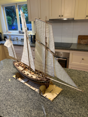

Almost there now the topsails are on
There’s still a bit of tidying up required on the lines on cleats, but I think that’s about it.
The halyards were a little difficult as there was a block that had to be seized onto the end of the line. This could only be done on the model so I had to stack some books up as a makeshift work surface to get the job done.
The flag material is very fine and started fraying as soon as I took it out of the cellophane packaging. I painted them with a mixture of PVA and water and before trimming off the excess. I added a small bolt rope with two eyes so they can be hoisted as on the real thing. I used toggles to attach the line to the flags. I’m not sure they would have been used in practice - probably a bowline would have sufficed - but I think they will look quite good.
The rest of the family is taking a bit of interest in Le Coureur and the discussion is turning to where she might be housed when she is finished. Although she’s quite long and high (950 x 650 mm), she’s relatively narrow (200 mm) so she could be safely displayed on a shelf or hall table.
Kind regards
Salty
