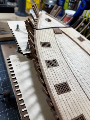

Hello all, starboard gun deck is installed with a few sub millimeter gaps, but I'll take it! What a relief. I just slid the main cabin bulkhead in to see the fitment, all looks well. Check it out.
View attachment 618688View attachment 618689
Still a lot of finishing sanding to do and a staining of the canon/ gun deck trim piece.
Looks excellent Daniel! Great job!

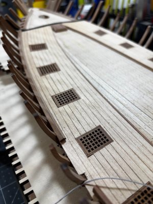

I've finished all the main and canon decking. Next, I need to finish the deck nails then start with the rear cabin wall planks and internal furnishings.
I'm looking forward to the interior hull planking in the cabin area for its a step toward removing the ship from its cradle.
Till next time.
Beautiful Daniel! She’s really coming alive now. ;)

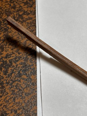

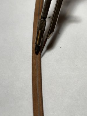

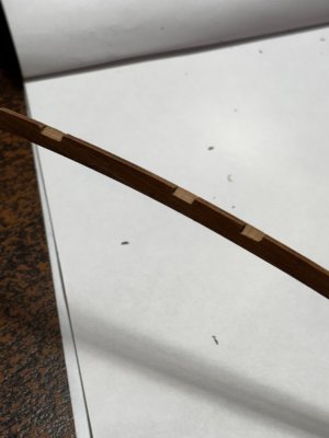

Good morning, all. I wanted to address the gun-deck edge molding against the bulwark standards. There are 3 pieces to each side of 3x5mm pear. These pieces have been laser cut to approximately match the hulls curvature. The problem is the inward facing edge needs to be chamfered for a nice-looking transition from deck to molding. Since the pieces are curved, I didn't know how make a jig to saw in this chamfer, so I used my trusty compass and drew in a line using the piece itself as my guide. Next, I had to freehand the chamfer using the lines as my guide and my trusty handheld rotary tool, so far, it's working great. The side up against the standards had to be beveled out as well. Those standards have their own curvature which crosses into the deck area causing this beveling process.
Check it out.
Now that I know how to do this step I can go back to the deck nails.
