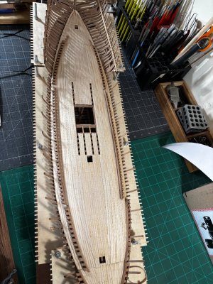

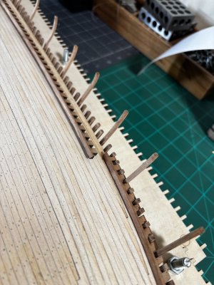

While drilling and filing holes representing deck nails, the rate of drill bit destruction is worth noting. Using 0.6mm drill bits, if you apply the slightest bit of lateral torsion the little things just snape off. I bought 2ea. 10 packs of bits from Amazon anticipating this problem and already down 6 bits in one pack. Ha! you wouldn't want me drilling on your teeth! ROTF .

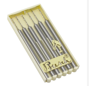

The ones below are definitely not cheap; they are premium priced, but...take my word, they will last you much longer. They occasionally break when drilling metal or brass, and putting extreme pressure. But for the wood, I have not had a chance to break one yet.

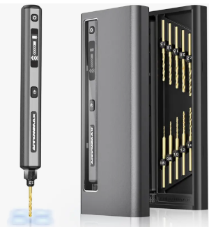

I got the little Arrowmax pen style drill set from Amazon and it is great. I have yet to break a bit. Of course, I'm not drilling 50,000 holes either. :) It's small and a bit slower than a Dremel and it's also easier to control.
