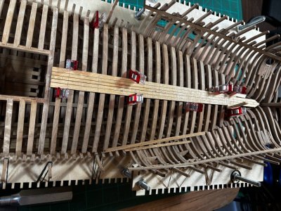

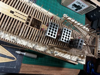

I have a weekend update, nothing spectacular just a little old fashion progress of the decking. This focus is on the aft portion of the deck. I've measured and double checked before glueing anything down, so while not all is perfect its very close. Check it out.
You can see I set one connecting piece on the port side; it had a glove tight fit which is very satisfying. I've set approximately 300 holes with 0.6mm wire and have oh I don't know maybe a few thousand more to go.:eek:

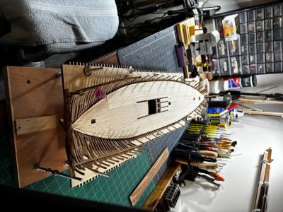

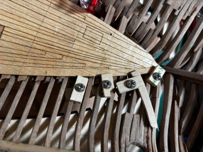

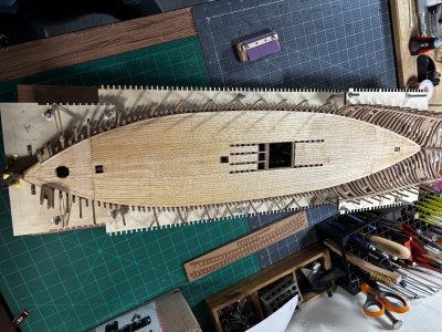

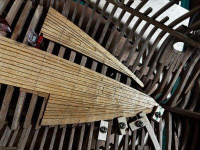

The main deck construction is almost finished. Her big beautiful wide expanse of decking is starting to take shape! The first photo is before sanding with a portion of deck nails in the forward bow mid-section installed. So, my question became what to do first, install the copper nails then sand or sand then place the nails. I concluded as can be seen in the second photo to sand first with 120 grit followed by 220 grit as a preparation for the remaining nails which will come next. I'm open to anyone with their opinions on nail then sand or sand then nail. Of course, with treenails it shouldn't matter as they would sand at about the same rate as the surrounding wood. Check this out.
I will apply final sanding after the rest of the nails are installed.
Thanks for checking in.

You mentioned sanding before or after installing deck plank nails. Aren't you worried about the difference in hardness between copper and wood? My own experience with materials with different hardnesses is that the softer material gets more of an abrasive action than the harder material does, resulting in protrusion of the harder material.
