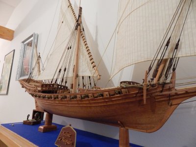

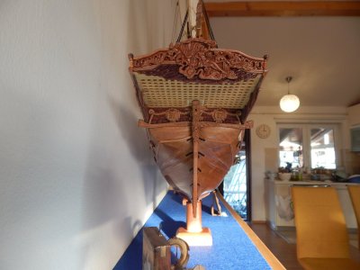

What you're commenting about the openings for displaying the ribs. I've been through that too, the line is very beautiful and it's a shame to lose it to show some of our skills. I even had the idea to make a small booklet with descriptions and pictures of individual parts of the construction, so if anyone is really interested, let them read it. Maybe I'll do it one day.
Good luck with your future work and enjoy it as much as you can.

Hello barba! I am delighted you found my build and thank you for your kind thoughts. As you can tell, your build along with another builder @GrantTyler, serves as my go to for inspiration. I have taken a break from building over the last few weeks but after the new year I plan on returning to the shipyard. I understand how owning your own company can be a challenge, I own a small cartography company which at times can be overwhelming.
The wood of my LeRequin is advertised as all pear, although I have my doubts about some of it being true pear. I will say that this build so far has been the most challenging one yet. In my mind's eye she will be a beauty when finished.
