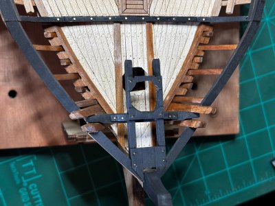

Next there is one short piece of black railing still to be set but I wanted to highlight the shaped support piece that goes in first.
View attachment 632208View attachment 632209
At the bow there is no inboard support piece like the rest of the ships railing.

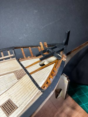

These last pictures just show fitment and symmetry. I am rather pleased with the ship's symmetry, somehow, I seem to be accomplishing this in spite of myself

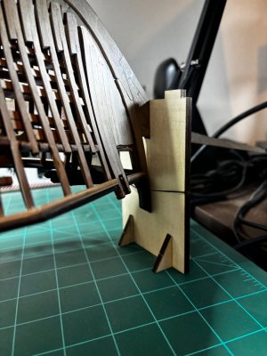

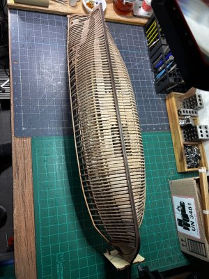

Congratulations with this milestone, Daniel. She looks impressive, showing her beautiful lines.I have arrived at a major milestone today. After finishing the rail system at the bow, I was able to quickly fab a support system to hold the ship inverted, free from the building jig for hull planking. First a couple shots of the bow section with a coating of stain finish.
View attachment 632533View attachment 632534

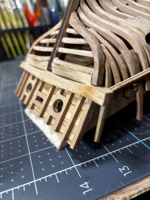

Next, I took a large block of balsa I had from a while back and a piece of the kits jig and repurposed them as shown.
So now begins the hull fairing, there are going to be a few stubborn locations requiring a lot of elbow grease which most of us have experienced before.

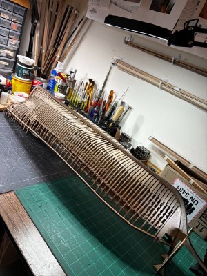

Here are a couple overall shots.View attachment 632536View attachment 632537

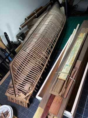

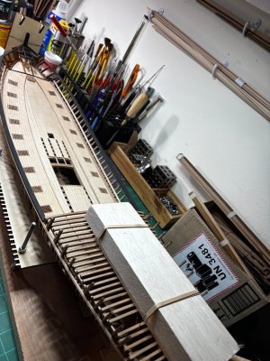

‘The hungrier you are, the better it tastes.’ You can’t wait to start sanding again, Daniel.Not much progress this last week and a half. I had just begun planking when my former boss sent me a set of plans for twin three span bridges to do a complete elevation workup. Here is a rather uninteresting picture just to show I'm still very much in this and will resume in the near future.
Thanks for watching.
Till next time.
