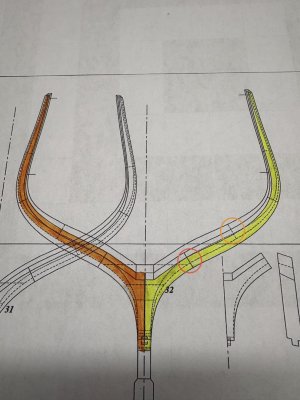

I am getting ready to start cutting frames. If I understand the plans for the frames, there are two frames for each frame drawn. In the picture below, the yellow shaded section is the face of the first frame and the orange shaded section is the face of the second frame. Then each frame is faired to its corresponding dotted line. Is this a correct assumption? I am having a hard time trying to determine which dotted line corresponds to which frame.
Could someone help me to understand this.
I greatly appreciate your patience and thank you all in advance for the help.
Thanks,
Bill
This still confuses me too. The best answer I can provide (at least what makes sense to me) is to look at the futtock section lines. The solid lines (red circle) are the frames in “front” and the dotted lines (orange circle) represent the “rear” frames.
So your highlighting should include the full width of these futtock sections.
The coarse dotted line is the outer edge of the rear frame while the fine dotted line represents the eventual fairing line
All the solid lines are visible when you look face on and the dotted lines are hidden.
Hopefully, some of this makes sense and is not simply more confusing.
Reach out if still confused and I’ll try and add some more clear details.

Thanks for your reply and help. This really helps. I hadn't looked at the futtock lines perpendicular to the body of the futtock. That makes things clearer. Also, I hate to admit it, but I did not notice that the dotted lines are two different sizes. That also makes things clearer. Now I need to let this to sink in.
