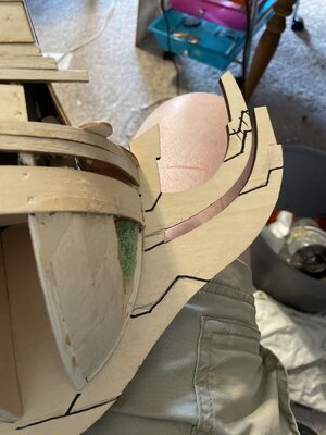

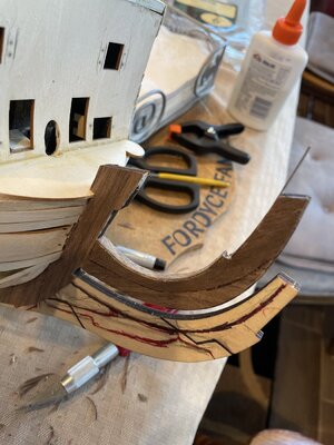

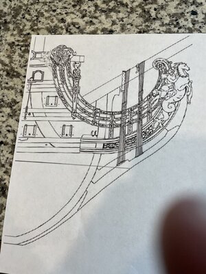

I’ve read in a couple of places that the stem should not be built using horizontal planks. The pieces were large pieces of wood that were jigsawed together. I haven’t been able to find any pictures of how this would look on the SR yet, but I’m projecting something like this. Any ideas?image.jpg

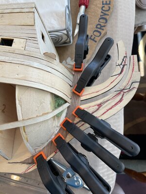

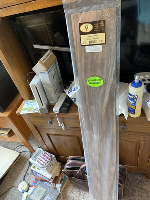

I bought some walnut veneer that I can use instead of the planking. image.jpg

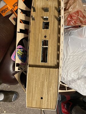

Very nice deck planking work Vic. I like the color of the wood!

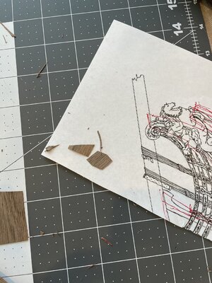

Thanks, Heinrich. It’s teak. What do you think about the covering of the stem and the keel with the irregular pieces of walnut. The kit called for horizontal planks all the way up to the top of the stem or front of the keel. I thought I saw a different way to do that somewhere where it looks like a jigsaw puzzle.
I veneered over plywood. The design of my kit called for planking (like yours) and by adding the veneer I was able to preserve the proper dimensions. Plus I didn't have tools or stock at the time to create these pieces from scratch. I do now but probably would have still gone with the veneer. It looks quite realistic to me.

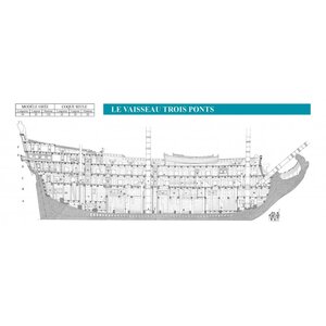

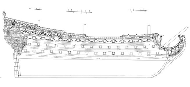

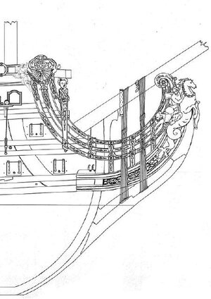

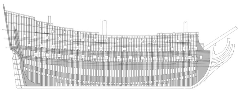

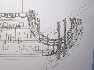

I hope I made it in time.Your vision of the components of the stem is wrong.They tried to collect the pieces along.As if they were building them on top of each other.Here are examples of how it was .See the drawings of Le Ambitieux
That’s why I asked well beforehand. That makes a lot of sense, @Mr.Deep. I’m glad you joined in the discussion. In fact, I tried drawing it after I took this picture, and it looked closer to your picture. But yours is obviously more accurate. Just what I was looking for!
