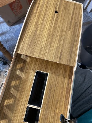

If you look at the picture, you will notice a black deck. There will be another deck to the left of it, but I can’t put it down until I place the guns that go below it. (6 of them). They have to be rigged first. They will be full guns and rigged. I have to put the guns in before I can put on the deck or I won’t be able to reach the guns to install them later. The right two guns are faux guns. The next three are full guns that will go under the deck. I can’t finish the planking until the deck is attached because the planks will attach to it. I can, however, plank everything up to just above where those guns will be, then place the guns, and then finish off the planking above the guns. If anyone has some better ideas, I am open to suggestions.

Here’s a picture. I’ve got a total of 10 complete guns with carriages going under decking. It will be difficult to place them after covering 8 of them with the aft deck. The forward 2 won’t be as hard to get to. And I can’t finish the hull above the guns before I attach the deck. I know @Gilbertm and @paulb did it somehow. I must have missed it in their builds.image.jpg
I don't understand what prevents you from sheathing the case first. The decks can be temporarily secured. You can use small nails, you can use drops of glue. Sheathe the body from the bottom up. Gradually you will reach the level of this deck. Do not forget to draw the barhouts first,install them first, then it will be easier to orient the second skin. Damn translator. Sorry, I'm writing from my phone.

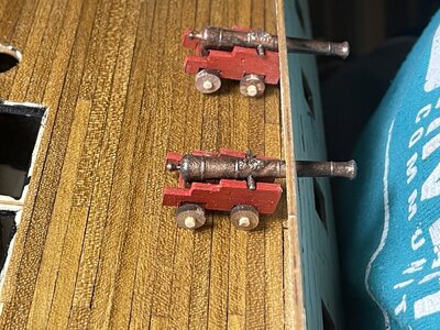

Regarding the cannon install on the top row - I installed just the carriages in the areas I couldn't get to. When the hull was completely finished, sanded and stained and it was time to install the cannons, I installed the cannons on the hidden carriages by putting epoxy on the cannon trunnions the fished them carefully through the cannon ports. I was able to install 6 completely built cannons and carriages on each side at the waist where they would be visible.

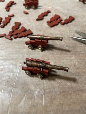

If I were to go back to the beginning of building the model now, I would throw these cars to hell.Make yourself normal French carriages.
I totally understand. These will not be seen under the deck very well. I don't have the tools to make my own, unfortunately. I know you prefer to make your own. I can probably make these to look more like French carriages. I also would like some bigger wheels for the front of the carriage. I have nothing to build them with.
