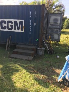

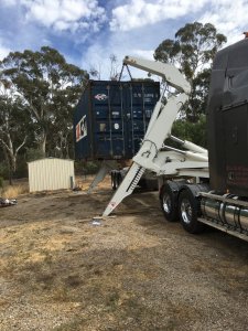

Great kit,I look forward to following along when you get settled.

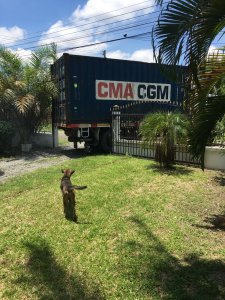

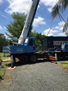

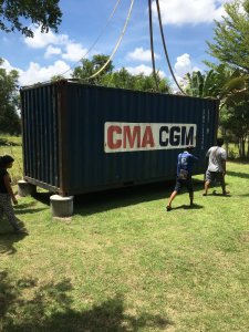

One piece of advice,ensure you insulate and install a vapour barrier in the container if you use it as a workshop.In our previous house,my workshop,the garage had a steel cladding roof.The amount of damp and water caused through condensation on the inside of the steel was unbelievable,you could see it running down inside.I reroofed it to solve the issue but it can easily be done to the inside of a steel container.

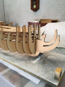

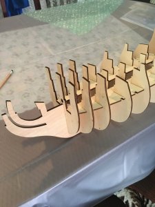

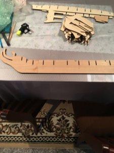

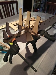

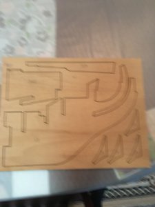

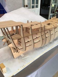

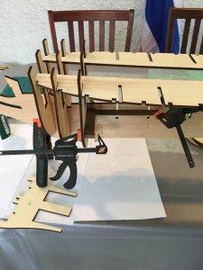

Started on the SR I will not show unboxing as it has been covered before. Keel and frames cutout, dry fitted with little sanding. I need to build a building board and cover tomorrow. I haven’t got any PVA glue, tried 3 store none carry PVA glue, so had to order online, means a 4-5 day wait.
