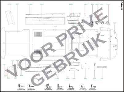

Joining body and chassis:
Group 5, steps 95+96:

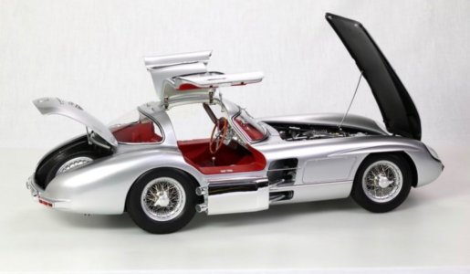

Your are right, Dean. That’s also with the Pocher Duc’s. But I can show the MB this way:
(With or without the ‘streetlegal’ Ebenspacher exhaust silencer …..)

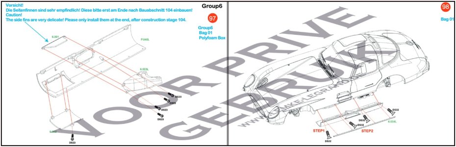

Group 6, steps 97 through 106:

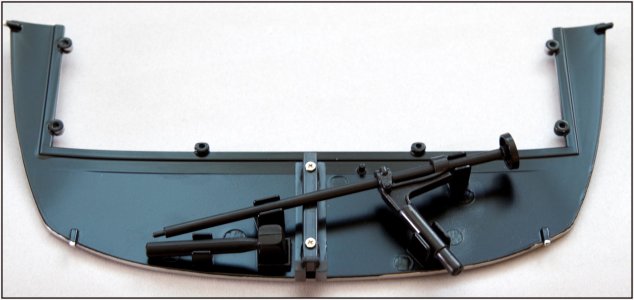

Even the car jack and a hammer were not forgotten on the bottom of the trunk lid:

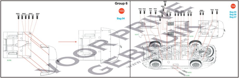

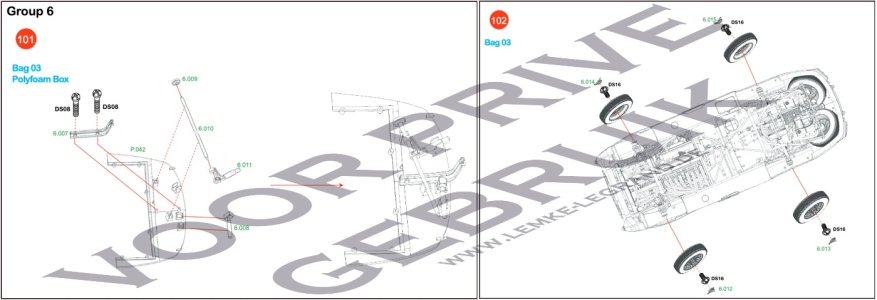

Installing the bottom plates:

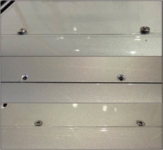

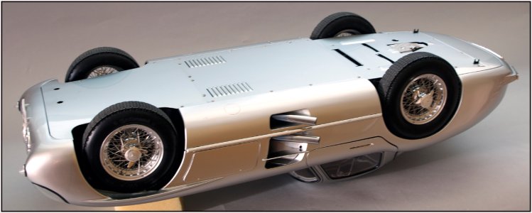

This is where Lemke-LeGrand does make a mistake. To secure these plates, all bolts with a countersunk head are used. So with a foamed underside. Consequently, those bolts stick out if the holes are not countersunk:
So I just did that myself.

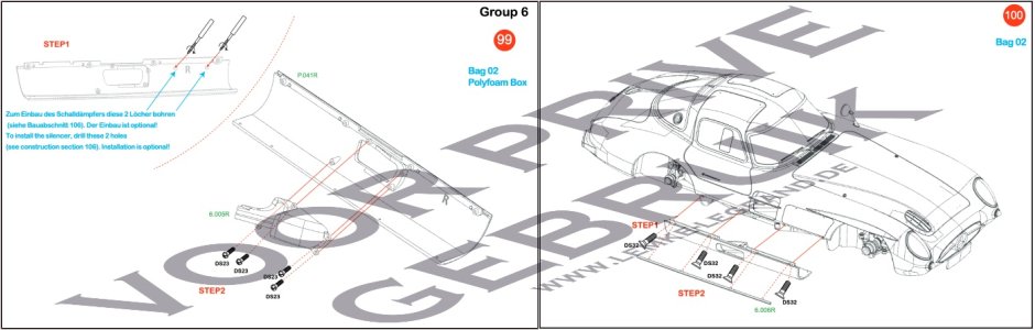

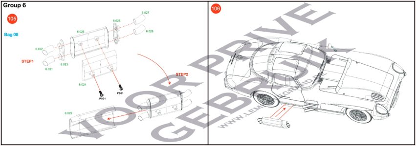

Group 6, steps 105+106:

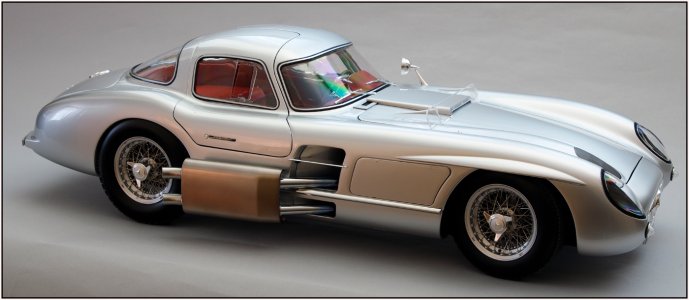

Finally, it is time to make the Ebenspächer muffler:

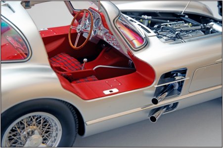

Here is one photo with the muffler installed separately. It was necessary to get it onto the public road, but then put a roof box on it too........:rolleyes::(
You won't see it again on the studio photos coming soon.:)

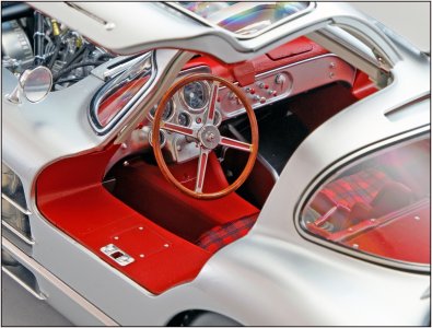

The driver sits with his right leg over the transmission / drive tunnel to reach the accelerator pedal:

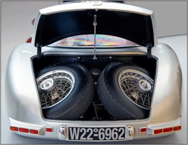

The 2 spare wheels:

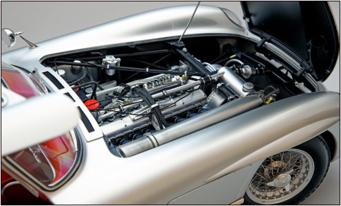

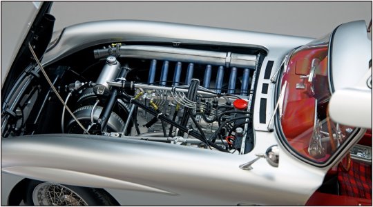

And the view on the impressive engine:
