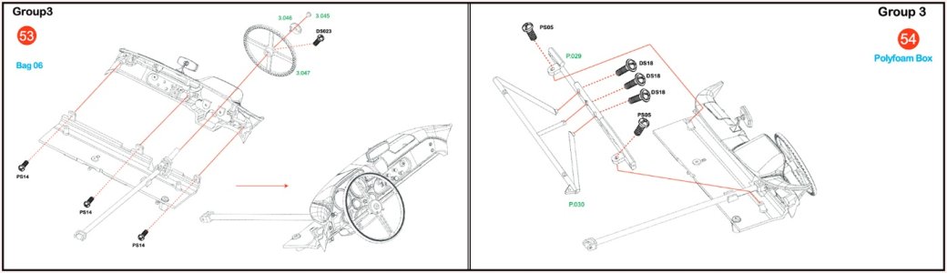

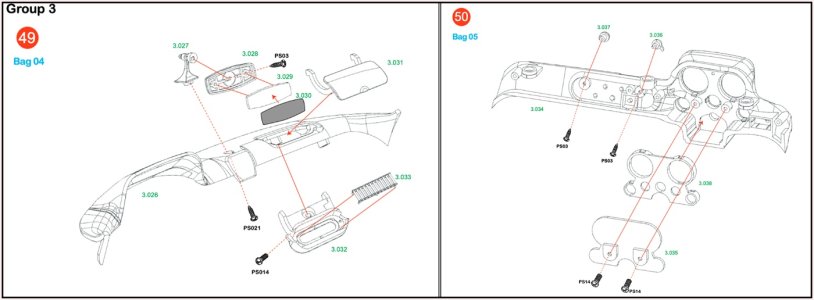

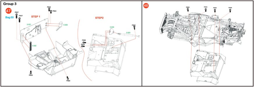

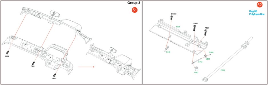

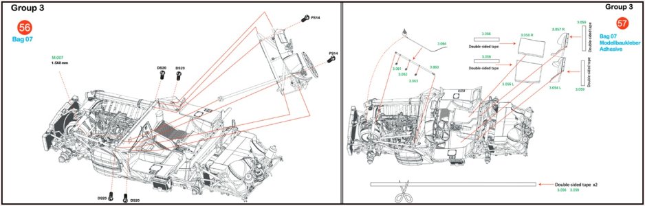

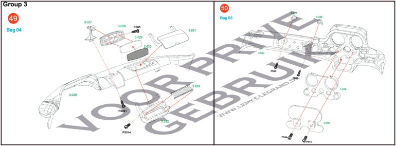

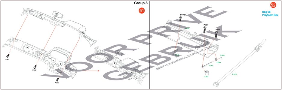

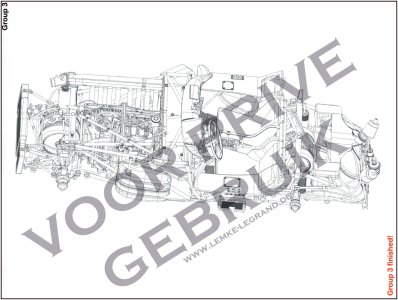

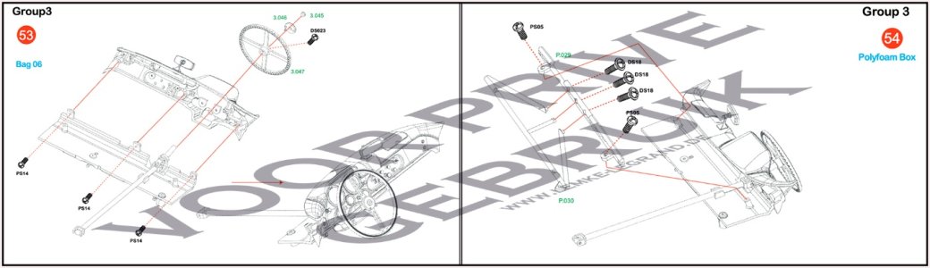

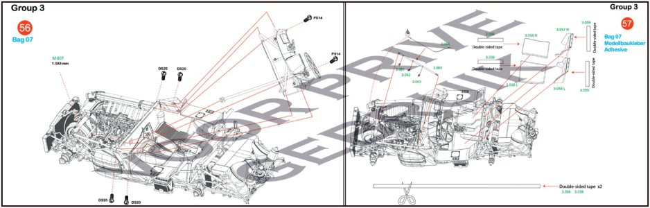

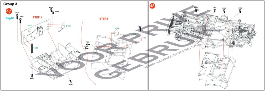

Group 3, steps 47 till 54:
Merging the interior and Dashboard.

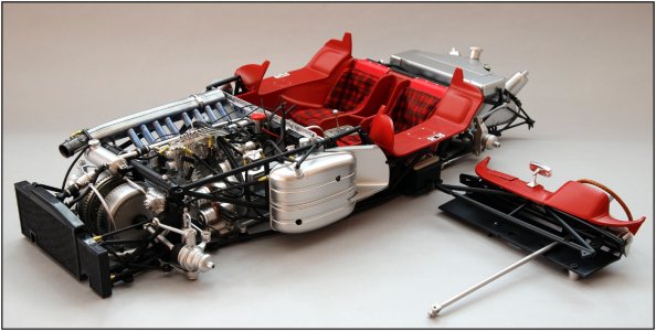

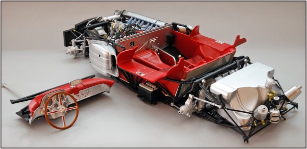

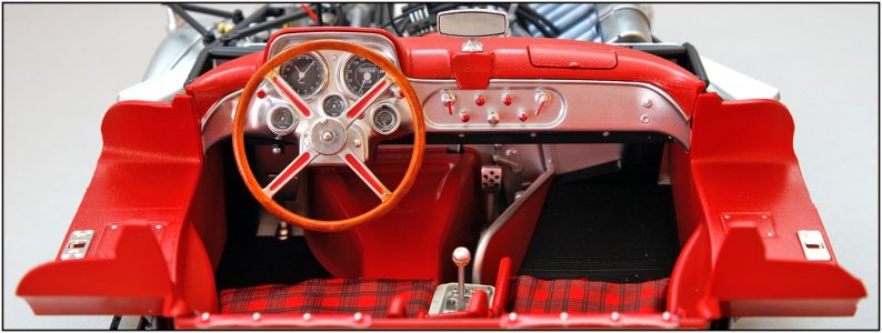

The base of the interior has been placed in the chassis and bolted down:
With the modular construction of the dashboard and subframe:
Where I can't quite follow Lemke-LeGrand's line of reasoning:
Then they add details to the underside of the dashboard that you'll never see. But I did that myself also with the Duc's too...;) We know it's there .....

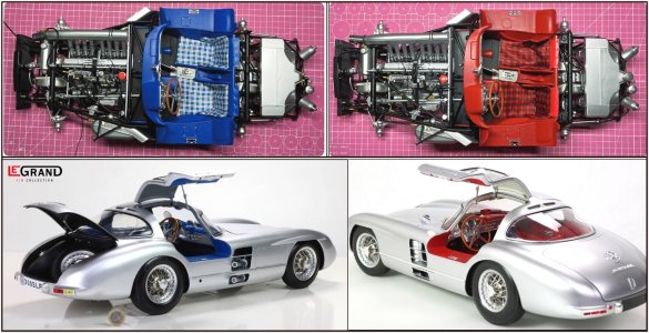

Yes it is, Paul. I liked the red / 'der Rote' more then the blue / 'der Blaue'. Her a comparison with some pictures from Lemke-LeGrand:

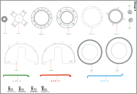

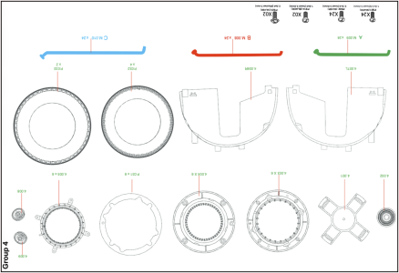

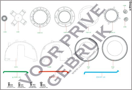

Group 4:

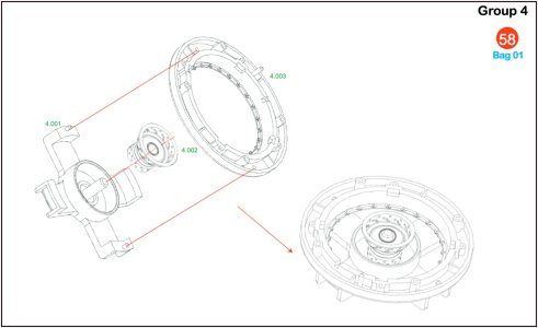

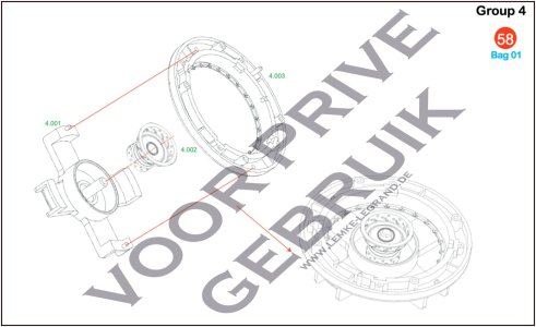

Group 4, step 58:

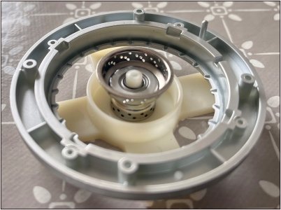

Spokes for the first wheel. Because this still required quite a bit of study, I took some photos of the intermediate steps.

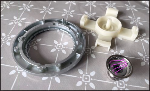

It's a jig on which you attach the first part of the rim and the hub:
On this wide side of the hub, there are 12 rows of 4 holes, diagonally above each other. The first and third will hold the spokes of section B. The second and fourth will hold the spokes of section A.
This is what it looks like:
The principle is somewhat similar to that of Pocher's spoke wheels.

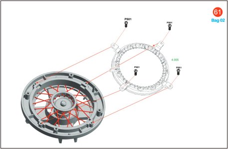

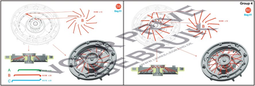

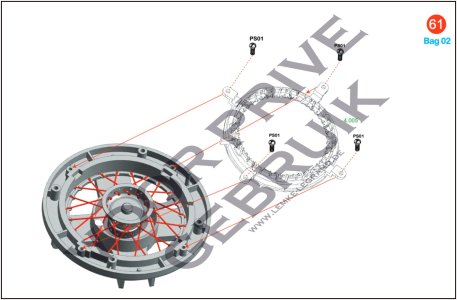

Group 4, steps 59 to 61:
On the left, the first 12 spokes of section B:
In the middle, all 24 spokes, and on the right, with the retaining ring.

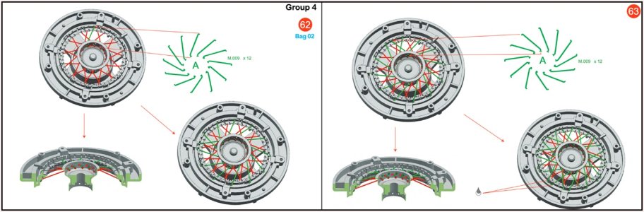

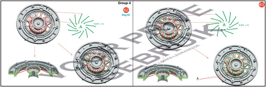

Group 4, steps 62+63:
All 24 spokes of section A:
The ends of the spokes are loose in the outer rim.

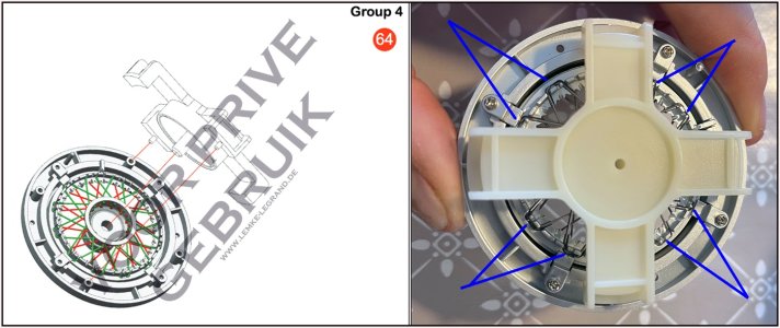

Group 4, step 64:

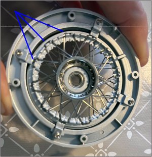

You now have to remove the template from the bottom and place it on top, on the spokes of section A. Then you have to turn the wheel over and continue with the spokes of section C.
When placing those spokes, I noticed that most of the spokes of section A were coming loose, and the spokes became a mess.
So I turned the wheel over again and secured all the ends of the spokes of section A with a bit of CA.
PS-1: I have no idea why they called the first 24 spokes B and the second 24 spokes A...........
PS-2 from March 11th: Now I see on the drawing of step ‘63’ that they show a glue drop ………. RTFM ……;)

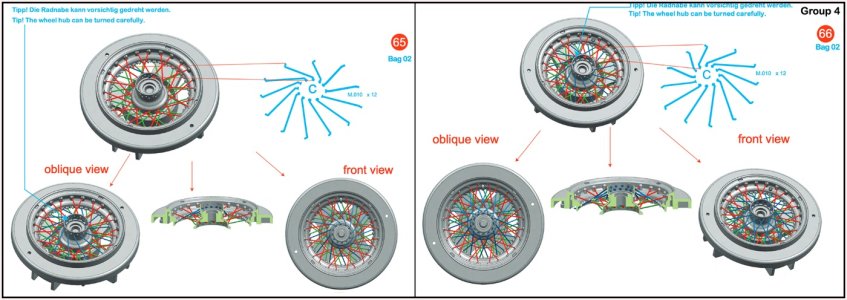

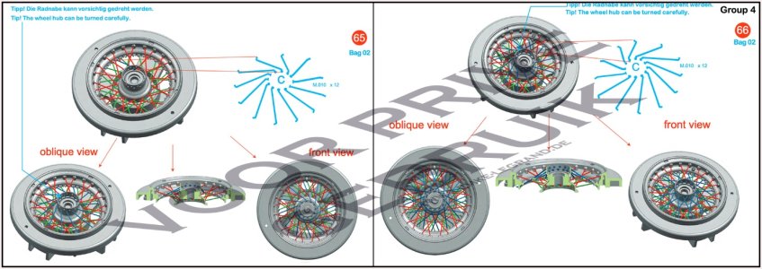

Group 4, steps 65+66:

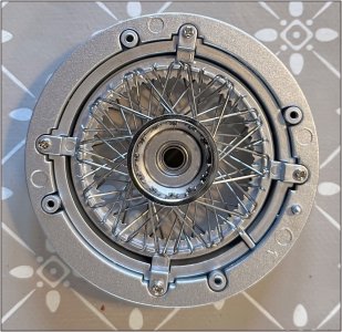

The narrow part of the rim is now on top. It contains 12 rows with two holes diagonally above each other:
For the first row of 12 spokes and for the second row of 12 spokes, use section C.
It takes some figuring out and careful study of the Lemke-LeGrand videos, but you have to weave the spokes from the rim through the other spokes so that they end up on the underside of the rim.
Once you've mastered the weaving pattern and turn the wheel over again after placing the two rows of 12 spokes, you'll get this view:
All the ends of 48 spokes on this side are in their recesses.

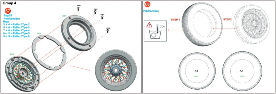

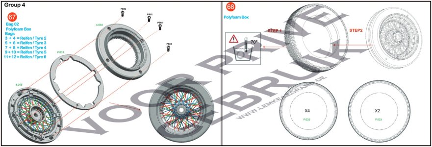

Group 4, steps 67+68:
The 48 ends are secured with a metal ring and secured to the second part of the rim. I forgot to take a picture of this.
Soak the tire in warm water for a while and tighten it around the rim:
The result is impressive.
The narrow part of the rim protrudes slightly beyond the rim flange. I placed the wheel there and turned it. The entire wheel is nice and straight and balanced.:)

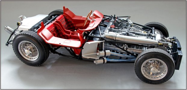

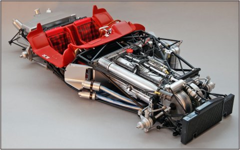

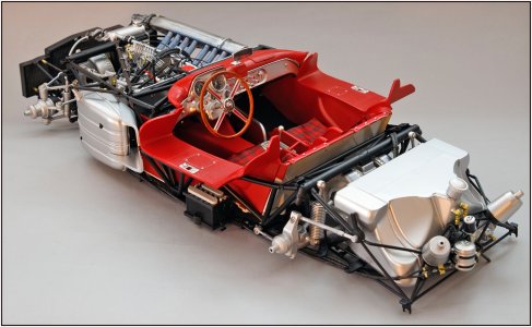

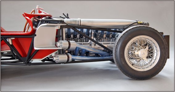

The engine block with exhaust from the right side:

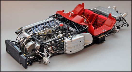

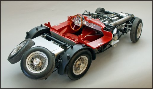

From a slightly lower perspective:

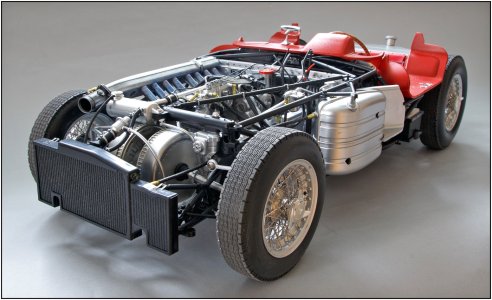

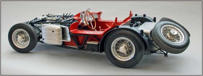

And now I could take this comparison photo:
On the left, the W196S with its spartan single-seat interior.

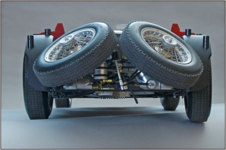

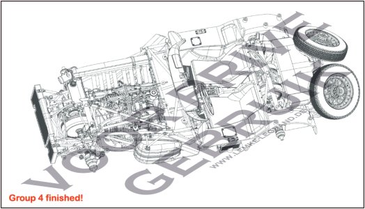

The last 2 wheels have also been assembled. It took me about 20 to 25 min. per wheel.

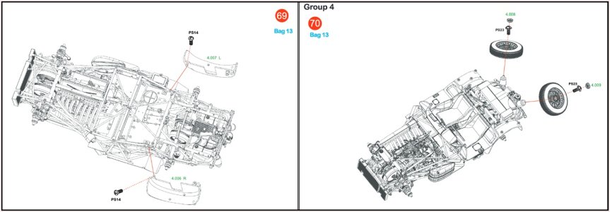

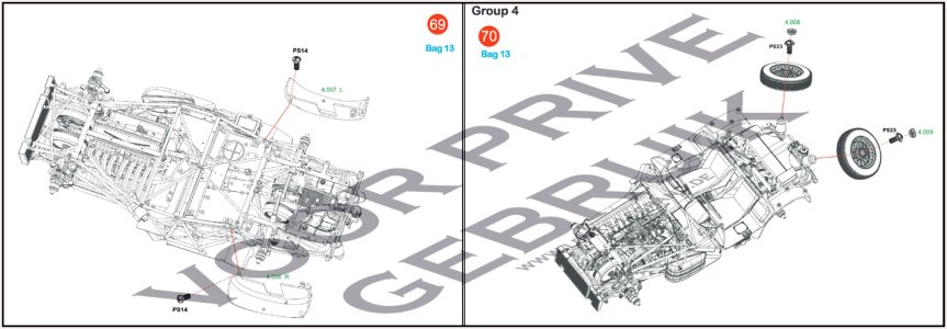

Group 4, step 69+70:
After 6x72 spokes, it looks like this now:
The spare wheels have also been used once already .....;)

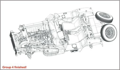

Group 4 is finished, 479 parts with 52 bolts.
That brings the total to 844 parts and 376 bolts.
