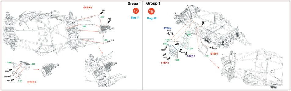

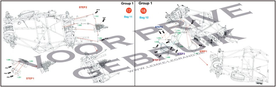

Group 1, steps 17+18.
The gearbox and coolant tank.

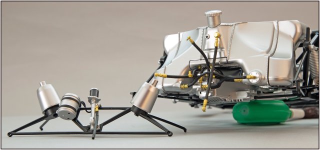

The gearbox will be photographed later; here's the tank with the hose:
The hoses are made of a nice material. Wire is braided into them so that a bend remains in that shape. This will become clearer later.

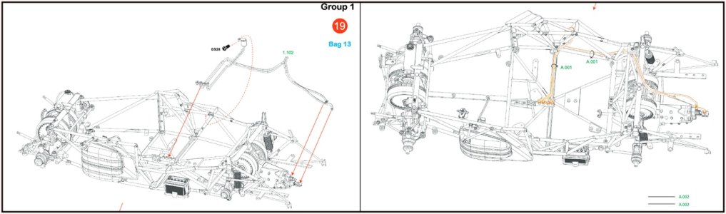

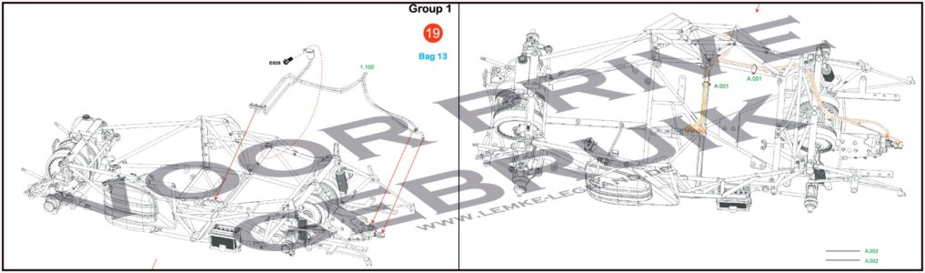

Group 1, step 19:
Distribution block with 4 hoses.
The drawings themselves are very clear. With the photos and video on the Lemke-LeGrand website, you can't go wrong.

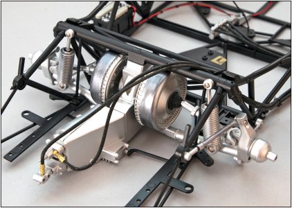

The two on the gearbox:
The connections are nicely detailed and color-coded. The gearbox has a chassis support on both sides.

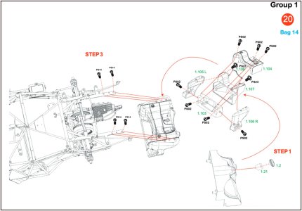

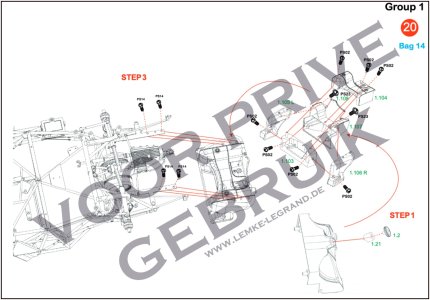

Group 1, step 20.

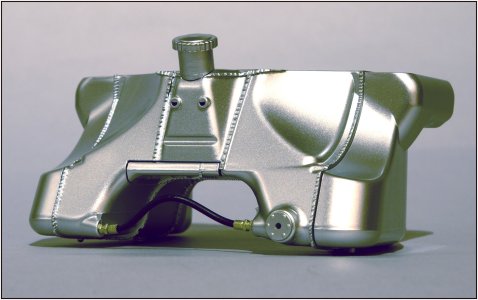

Fuel tank.
The assembly is quite ingenious, including two internal screws:
They've also made the welds stand out beautifully.

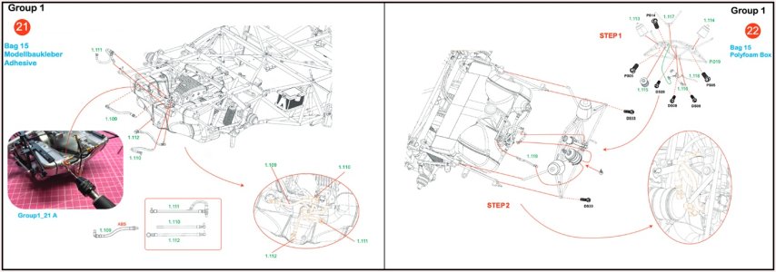

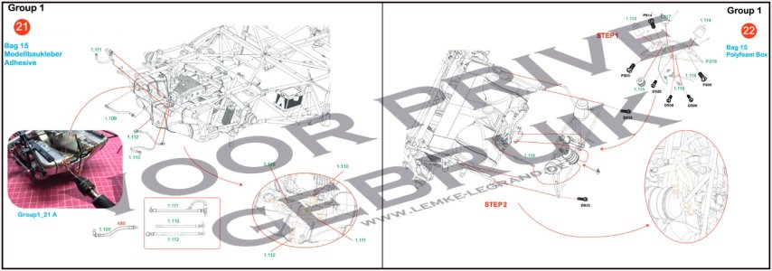

Group 1, steps 21+22.
The first 4 hoses, rear subframe, fuel filter, and spare tire supports.

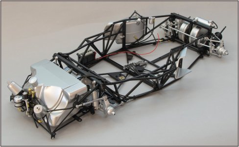

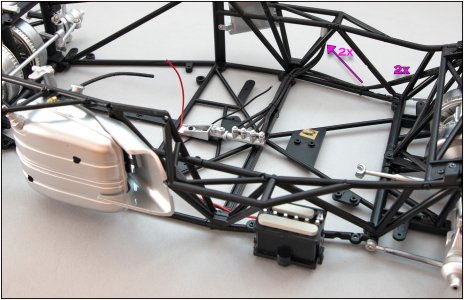

The subframe wasn't mounted yet for this photo:

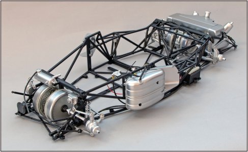

It took me a while to get this part in place properly. Several hoses each have their own route through this small piece of truss frame. They run through and over pipes.

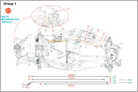

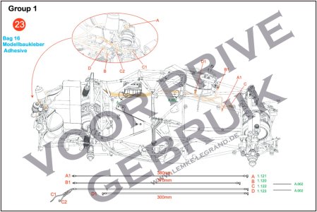

Group 1, step 23.

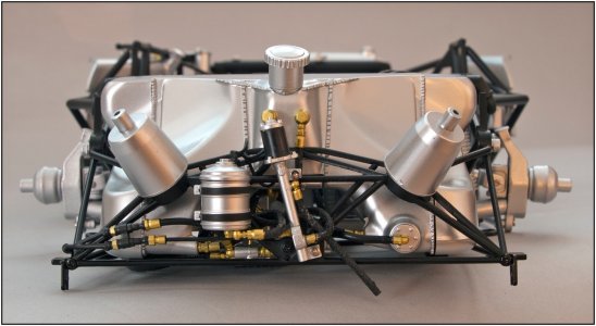

The last 4 hoses.

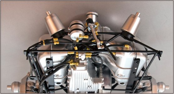

I had to study a bit before I connected all 4 hoses properly. The photos and videos on the Lemke-LeGrand site were a welcome help. Right from the back:

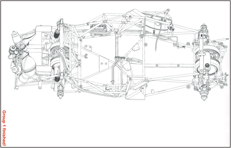

Here I've lifted the rear end:
It's a veritable spaghetti of tubes.

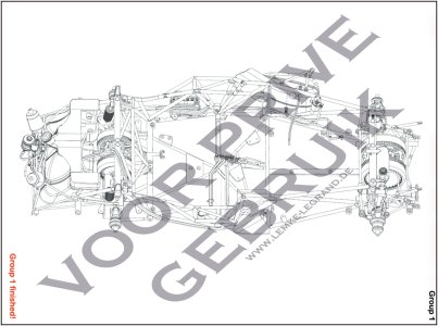

This Group 1 contained 160 parts and had 169 bolts. (Just fun to keep track of ... ;))
