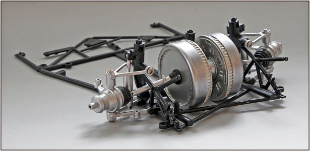

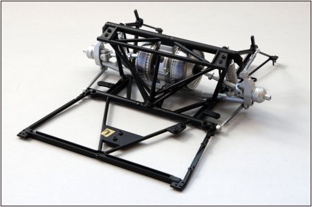

Two interesting parts right away: the drum brakes.
Here's a look at the previous photo, with the front brakes circled:
Rodolf Uhlenhout opted for large drum brakes because he wasn't entirely confident yet with the recently invented disc brakes.
Specs: inboard duplex drum drakes with power assist, Front: 350mm (13.8 in), Rear: 275mm (10.8 in).
Because he wanted to keep the unsprung weight as low as possible, he placed the drums on the inner fixed parts of the axles. This allowed him to install larger brakes that otherwise wouldn't fit within the wheels.
Group 1, step 3-2:
The rear suspension and drivetrain are starting to become visible. It started with some small color accents using graphite. In the photo with the circled drum brakes, you can see that the brake segments are interconnected on the inner side. They are just visible on the insert at the top left. This will no longer be visible on the model at this rear axle. Maybe on the front axle. Anyway, it's just fun to add something yourself. Of course, you can also just bolt everything together ....;)
I find all the silver parts together unattractive.
That's why I gave the stabilizer bars and the brake drums a light wash to add some subtle accents.

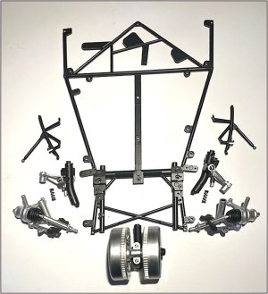

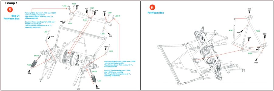

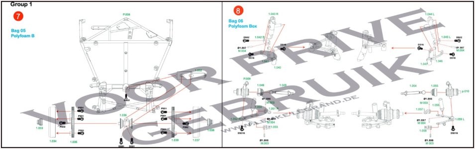

Group 1, Steps 7 and 8:
The brake drums, wheel axles, and double wishbone front suspension:
After assembling 39 parts and 19 bolts, these are the components:
This frame part is a piece of art on itself.

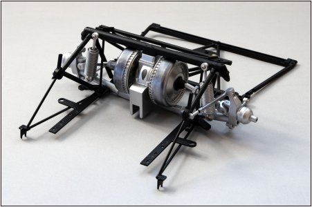

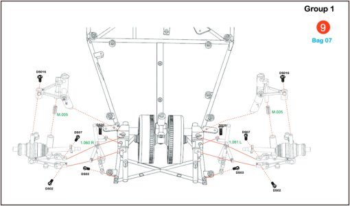

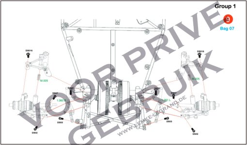

Group 1, Step 9:
With another 2 frame parts and 10 bolts, these are the two steering axles and double wishbone suspension:

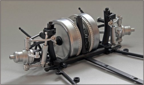

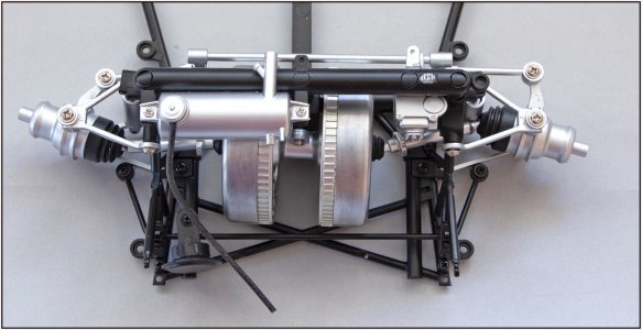

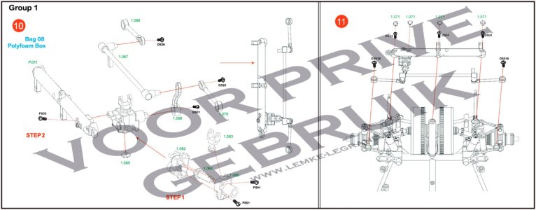

Group 1, Step 10+11:
Stabelizer beam and steering mechanism:

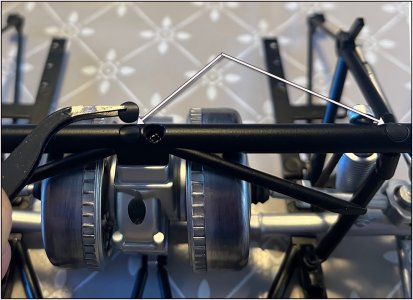

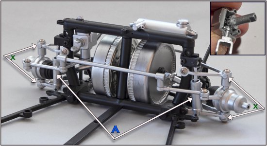

After this was installed, I still had to make some adjustments:
The springs in both shock absorbers 'A' are a bit too tight. Because the 4 bushings 'X' on the two vertical axes don't pivot (the first minor issue I encountered), there's quite a bit of tension on all the pivot points. And you have to apply (too) much force to make a steering angle. I disassembled the whole thing twice to squeeze both springs a little more each time. With the bevel gear steering, see the insert at the top right, a steering angle can now be made.

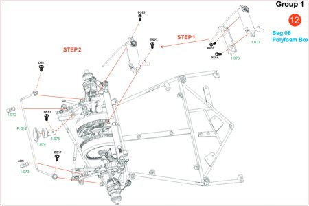

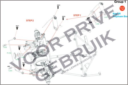

Torsion bar suspension:
This type of suspension was used instead of struts.
Even rubber damping blocks weren't forgotten:
That deserves a plus point... ;)

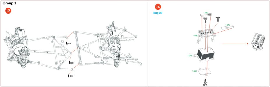

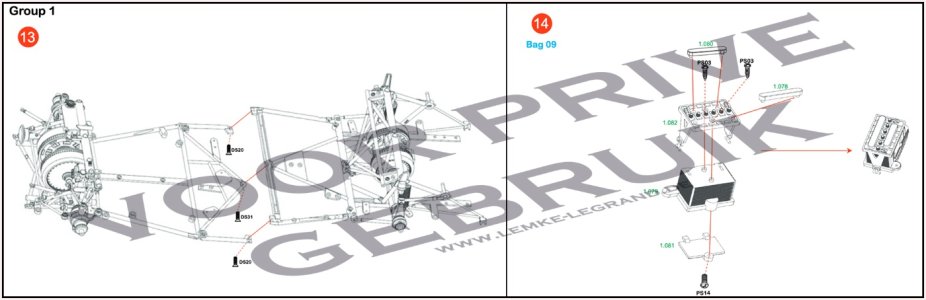

Group 1, Step 13+14:
Assembling 2 parts + battery:

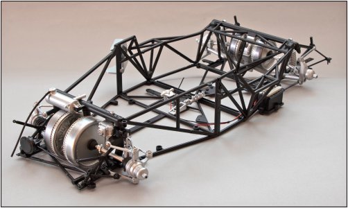

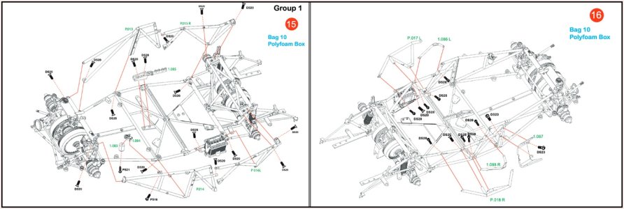

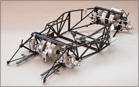

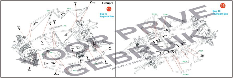

Group 1, Step 15+16:
Assembling the tubular space frame:
The tubular space3 frame looks like this:
The already neatly detailed battery already has holes in the '+' and '-' clamps. But I can't find anywhere in the entire manual that you have to install the wires. So I attached a black and a red one myself.
These will later find their way into the electrical circuit.
124 parts and 131 bolts installed so far.
