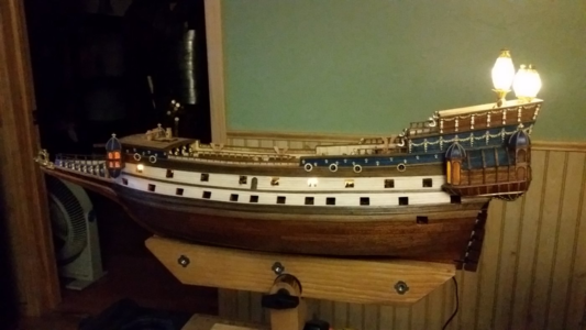

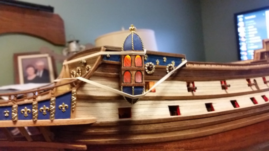

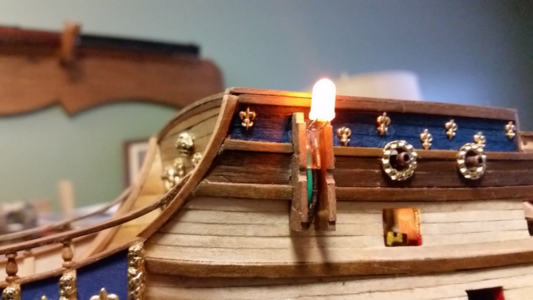

You have to scratch build the lanterns usually. You can glue slivers of wood and small cut pieces over the LED, or rig lights to be indirect, placing the LED's in places where you cannot see them directly after the model is complete. Olha Batchvarov is currently working on the Ragusa Carrack and has a very organized lighting system in her build videos on YouTube that you should watch. My wiring was routed crudely attached the underside of the weather deck, but it is not visible even through the upper deck gun ports. and the LED's are placed so they cannot be seen directly.
Example showing LED placement in a turret. The LED is in a hole bored into the bottom of the turret cap.
Nano LED's were installed inside the stern lanterns, and are far less bright than the picture actually shows, as are the LED's on the upper gun deck. The cell phone camera can't balance direct light sources with the background lighting. In the side galleries below, the LED is located inside the gallery between the two towers, and light spills out the windows for a realistic effect.

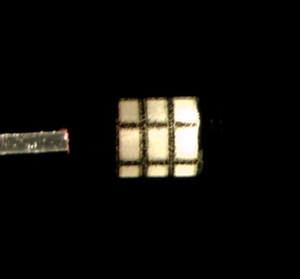

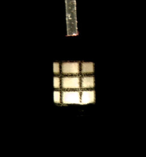

Hi,
I took an LED and drilled a hole through the top and put a small brass ring into it, then used strips of copper tape to out line the cage effect, painted the led around the top above the horizontal copper strip.
The led leads can be painted with beige enamel and a bit of very small black lines to simulate rope.

Hi,
GENIUS! Fake lanterns!
