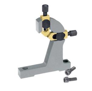

ShopTask. Post #16 above. I've had it for 30 years, hard to imagine.I am just now seeing this post - yes, the reason for the deflection is the dowel that you are turning is thin. In order to avoid this, you really need to have a "Steady Rest" mounted either 1/3 or 1/2 or 2/3 of the way. The Jaws will just touch the work piece and keep the dowel from deflecting. I don't remember seeing a post of what kind of Lathe you have. The bottom part of this slides our mounts to the "ways".
I kinda like that one. It would work better on my lathe. I think rollers would work better than those pointed jaws though. Unless I'm misunderstanding. I may be able to make one of those.Another concept is the Follower Rest. This will mount on the cross slide and will follow along with the cross slide. This way, no matter where the cutting tool is, this attachment will be installed opposite of the cutting tool as it travels along.
