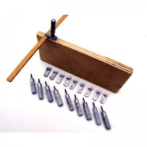

I suffered an injury from pushing in the pins by hand. It is hard to penetrate the plywood. As a result I damaged my nerves in my index finger. That finger is repairing, but after 24 hours I still feel some numbness at the finger tip. I tried using pliers, but it is difficult the hold the boat with one hand while with the other hand trying to keep the pin steady with the pliers under plressure. Everything went sideways and I broke the plank. Have you any tips for me?

I am using such pins.....in german they are called "Stossnadel" - means "pushing pins"......they are much shorter and you can use much more pressure on the pin

I use a smaller diameter drill to drill a pilot hole, you only need to go a few mm deep, it makes it easier to push the pins in.
